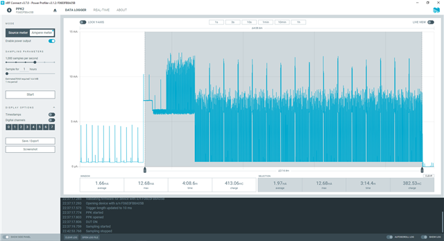

    2). when i had set to 7.5-100ms the current between logs was
    556.76 µA
    but when connection interval was 1000ms it increased to
    685.85 µA
    why is the current between logs increasing?

    It is hard for me to speculate about this without seeing the current code.
    However, this might be another symptom of the issue you are seeing with the missing / less-than-expected logging. I suggest that we focus on resolving this issue first, so that we potentially does not spend time debugging a symptom that may go away when we resolve the root issue.

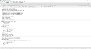

    I am not sure we will be getting anywhere with this until we see a sniffer trace. Could you capture a sniffer trace of these two scenarios, and upload the traces along with the peripheral's logs?

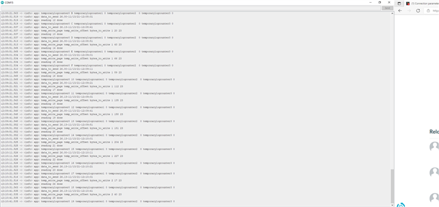

  • with above configuration i get many log values and logging continues:

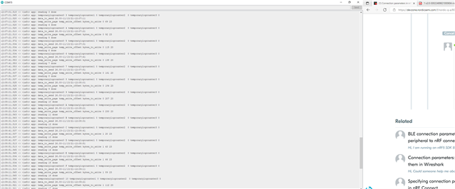

    but with
    after 16 logs nothing happens and logs stop without any error but in power profiler i saw that logging stopped after 16 values
    no value after 16 logs
  • Please share logs using the Insert -> Code -> Text option rather than sharing screenshots of the logs. Proper formatting drastically increases readability and thus makes debugging easier.

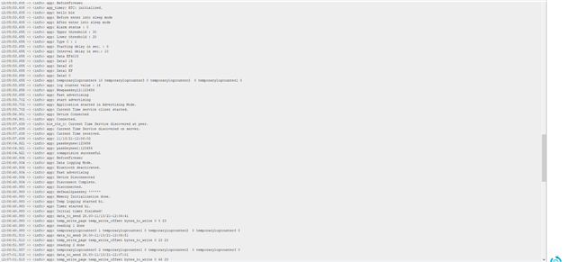

    Please also show me the log for the scenario in which the application seemingly stops after 16 logs.
    Have you run a debugging session and checked out if the program counter gets stuck anywhere following the 16'th logging?
    Please see my previous comment about the sniffer.
    Could you capture a sniffer trace of these two scenarios in addition to the logs?

  • 17:26:10.658 -> <info> app: BeforeFivesec
    17:26:10.658 -> <info> app_timer: RTC: initialized.
    17:26:10.658 -> <info> app: hello ble
    17:26:10.658 -> <info> app: Before enter into sleep mode
    17:26:10.705 -> <info> app: After enter into sleep mode
    17:26:10.705 -> <info> app: Alarm status : 0
    17:26:10.705 -> <info> app: Upper threshold : 30
    17:26:10.705 -> <info> app: Lower threshold : 20
    17:26:10.705 -> <info> app: Type C : 1
    17:26:10.705 -> <info> app: Starting delay in sec. : 0
    17:26:10.705 -> <info> app: Interval delay in sec.: 10
    17:26:10.705 -> <info> app: Data EF4015
    17:26:10.705 -> <info> app: Data3 15
    17:26:10.705 -> <info> app: Data2 40
    17:26:10.705 -> <info> app: Data1 EF
    17:26:10.705 -> <info> app: Data0 0
    17:26:10.705 -> <info> app: temporarylogcounter4 10 temporarylogcounter3 0 temporarylogcounter2  0 temporarylogcounter1 0
    17:26:10.705 -> <info> app: log counter value : 16
    17:26:10.705 -> <info> app: Newpasskey12:123456
    17:26:10.752 -> <info> app: Fast advertising
    17:26:10.752 -> <info> app: start advertising
    17:26:10.752 -> <info> app: Application started in Advertising Mode.
    17:26:10.752 -> <info> app: Current Time service client started.
    17:26:16.257 -> <info> app: Device Connected
    17:26:16.257 -> <info> app: Connected.
    17:26:16.914 -> <info> ble_cts_c: Current Time Service discovered at peer.
    17:26:16.914 -> <info> app: Current Time Service discovered on server.
    17:26:17.009 -> <info> app: Current Time received.
    17:26:17.009 -> <info> app: 11/16/21-17:26:24
    17:26:30.180 -> <info> app: passkeynew:123456
    17:26:30.180 -> <info> app: passkeynew1:123456
    17:26:30.180 -> <info> app: comaprision successful
    17:27:05.129 -> <info> app: BeforeFivesec
    17:27:05.129 -> <info> app: Data logging Mode.
    17:27:05.176 -> <info> app: Bluetooth deactivated.
    17:27:05.176 -> <info> app: Fast advertising
    17:27:05.176 -> <info> app: Device Disconnected
    17:27:05.176 -> <info> app: Disconnect Complete.
    17:27:05.176 -> <info> app: Disconnected.
    17:27:05.176 -> <info> app: defaualtpasskey ******
    17:27:05.176 -> <info> app: Memory Initialization done.
    17:27:05.176 -> <info> app: Temp Logging started hi.
    17:27:05.176 -> <info> app: Timer started hi.
    17:27:05.176 -> <info> app: Initial timer finished!
    17:27:05.176 -> <info> app: data_to_send 25.88-11/16/21-17:27:05
    17:27:05.176 -> <info> app: temp_write_page temp_write_offset bytes_to_write 0 0 23
    17:27:05.176 -> <info> app: reading 1 done
    17:27:05.176 -> <info> app: temporarylogcounter0 1 temporarylogcounter1 0 temporarylogcounter2  0 temporarylogcounter3 0
    17:27:15.809 -> <info> app: data_to_send 25.88-11/16/21-17:27:16
    17:27:15.809 -> <info> app: temp_write_page temp_write_offset bytes_to_write 0 23 23
    17:27:15.809 -> <info> app: reading 2 done
    17:27:15.809 -> <info> app: temporarylogcounter0 2 temporarylogcounter1 0 temporarylogcounter2  0 temporarylogcounter3 0
    17:27:25.810 -> <info> app: data_to_send 25.88-11/16/21-17:27:26
    17:27:25.810 -> <info> app: temp_write_page temp_write_offset bytes_to_write 0 46 23
    17:27:25.810 -> <info> app: reading 3 done
    17:27:25.810 -> <info> app: temporarylogcounter0 3 temporarylogcounter1 0 temporarylogcounter2  0 temporarylogcounter3 0
    17:27:35.800 -> <info> app: data_to_send 25.88-11/16/21-17:27:36
    17:27:35.800 -> <info> app: temp_write_page temp_write_offset bytes_to_write 0 69 23
    17:27:35.800 -> <info> app: reading 4 done
    17:27:35.800 -> <info> app: temporarylogcounter0 4 temporarylogcounter1 0 temporarylogcounter2  0 temporarylogcounter3 0
    17:27:45.787 -> <info> app: data_to_send 25.88-11/16/21-17:27:46
    17:27:45.787 -> <info> app: temp_write_page temp_write_offset bytes_to_write 0 92 23
    17:27:45.834 -> <info> app: reading 5 done
    17:27:45.834 -> <info> app: temporarylogcounter0 5 temporarylogcounter1 0 temporarylogcounter2  0 temporarylogcounter3 0
    17:27:55.823 -> <info> app: data_to_send 25.88-11/16/21-17:27:56
    17:27:55.823 -> <info> app: temp_write_page temp_write_offset bytes_to_write 0 115 23
    17:27:55.823 -> <info> app: reading 6 done
    17:27:55.823 -> <info> app: temporarylogcounter0 6 temporarylogcounter1 0 temporarylogcounter2  0 temporarylogcounter3 0
    17:28:05.811 -> <info> app: data_to_send 25.75-11/16/21-17:28:06
    17:28:05.811 -> <info> app: temp_write_page temp_write_offset bytes_to_write 0 138 23
    17:28:05.811 -> <info> app: reading 7 done
    17:28:05.811 -> <info> app: temporarylogcounter0 7 temporarylogcounter1 0 temporarylogcounter2  0 temporarylogcounter3 0
    17:28:15.801 -> <info> app: data_to_send 25.88-11/16/21-17:28:16
    17:28:15.801 -> <info> app: temp_write_page temp_write_offset bytes_to_write 0 161 23
    17:28:15.801 -> <info> app: reading 8 done
    17:28:15.801 -> <info> app: temporarylogcounter0 8 temporarylogcounter1 0 temporarylogcounter2  0 temporarylogcounter3 0
    17:28:25.789 -> <info> app: data_to_send 25.88-11/16/21-17:28:26
    17:28:25.789 -> <info> app: temp_write_page temp_write_offset bytes_to_write 0 184 23
    17:28:25.789 -> <info> app: reading 9 done
    17:28:25.789 -> <info> app: temporarylogcounter0 9 temporarylogcounter1 0 temporarylogcounter2  0 temporarylogcounter3 0
    17:28:35.807 -> <info> app: data_to_send 25.88-11/16/21-17:28:36
    17:28:35.807 -> <info> app: temp_write_page temp_write_offset bytes_to_write 0 207 23
    17:28:35.807 -> <info> app: reading 10 done
    17:28:35.807 -> <info> app: temporarylogcounter0 A temporarylogcounter1 0 temporarylogcounter2  0 temporarylogcounter3 0
    17:28:45.788 -> <info> app: data_to_send 25.75-11/16/21-17:28:46
    17:28:45.788 -> <info> app: temp_write_page temp_write_offset bytes_to_write 0 230 23
    17:28:45.835 -> <info> app: reading 11 done
    17:28:45.835 -> <info> app: temporarylogcounter0 B temporarylogcounter1 0 temporarylogcounter2  0 temporarylogcounter3 0
    17:28:55.799 -> <info> app: data_to_send 25.75-11/16/21-17:28:56
    17:28:55.799 -> <info> app: reading 12 done
    17:28:55.799 -> <info> app: temporarylogcounter0 C temporarylogcounter1 0 temporarylogcounter2  0 temporarylogcounter3 0
    17:29:05.819 -> <info> app: data_to_send 25.63-11/16/21-17:29:06
    17:29:05.819 -> <info> app: temp_write_page temp_write_offset bytes_to_write 1 20 23
    17:29:05.819 -> <info> app: reading 13 done
    17:29:05.819 -> <info> app: temporarylogcounter0 D temporarylogcounter1 0 temporarylogcounter2  0 temporarylogcounter3 0
    17:29:15.791 -> <info> app: data_to_send 25.63-11/16/21-17:29:16
    17:29:15.791 -> <info> app: temp_write_page temp_write_offset bytes_to_write 1 43 23
    17:29:15.791 -> <info> app: reading 14 done
    17:29:15.791 -> <info> app: temporarylogcounter0 E temporarylogcounter1 0 temporarylogcounter2  0 temporarylogcounter3 0
    17:29:25.826 -> <info> app: data_to_send 25.63-11/16/21-17:29:26
    17:29:25.826 -> <info> app: temp_write_page temp_write_offset bytes_to_write 1 66 23
    17:29:25.826 -> <info> app: reading 15 done
    17:29:25.826 -> <info> app: temporarylogcounter0 F temporarylogcounter1 0 temporarylogcounter2  0 temporarylogcounter3 0
    17:29:35.783 -> <info> app: data_to_send 25.63-11/16/21-17:29:36
    17:29:35.830 -> <info> app: temp_write_page temp_write_offset bytes_to_write 1 89 23
    17:29:35.830 -> <info> app: reading 16 done
    17:29:35.830 -> <info> app: temporarylogcounter0 10 temporarylogcounter1 0 temporarylogcounter2  0 temporarylogcounter3 0
    17:29:45.819 -> <info> app: data_to_send 25.63-11/16/21-17:29:46
    17:29:45.819 -> <info> app: temp_write_page temp_write_offset bytes_to_write 1 112 23
    17:29:45.819 -> <info> app: reading 17 done
    17:29:45.819 -> <info> app: temporarylogcounter0 11 temporarylogcounter1 0 temporarylogcounter2  0 temporarylogcounter3 0
    17:29:55.804 -> <info> app: data_to_send 25.63-11/16/21-17:29:56
    17:29:55.804 -> <info> app: temp_write_page temp_write_offset bytes_to_write 1 135 23
    17:29:55.804 -> <info> app: reading 18 done
    17:29:55.804 -> <info> app: temporarylogcounter0 12 temporarylogcounter1 0 temporarylogcounter2  0 temporarylogcounter3 0
    17:30:05.819 -> <info> app: data_to_send 25.63-11/16/21-17:30:06
    17:30:05.819 -> <info> app: temp_write_page temp_write_offset bytes_to_write 1 158 23
    17:30:05.819 -> <info> app: reading 19 done
    17:30:05.819 -> <info> app: temporarylogcounter0 13 temporarylogcounter1 0 temporarylogcounter2  0 temporarylogcounter3 0
    17:30:15.813 -> <info> app: data_to_send 25.50-11/16/21-17:30:16
    17:30:15.813 -> <info> app: temp_write_page temp_write_offset bytes_to_write 1 181 23
    17:30:15.813 -> <info> app: reading 20 done
    17:30:15.813 -> <info> app: temporarylogcounter0 14 temporarylogcounter1 0 temporarylogcounter2  0 temporarylogcounter3 0
    17:30:25.820 -> <info> app: data_to_send 25.50-11/16/21-17:30:26
    17:30:25.820 -> <info> app: temp_write_page temp_write_offset bytes_to_write 1 204 23
    17:30:25.820 -> <info> app: reading 21 done
    17:30:25.820 -> <info> app: temporarylogcounter0 15 temporarylogcounter1 0 temporarylogcounter2  0 temporarylogcounter3 0
    17:30:35.790 -> <info> app: data_to_send 25.50-11/16/21-17:30:36
    17:30:35.790 -> <info> app: temp_write_page temp_write_offset bytes_to_write 1 227 23
    17:30:35.790 -> <info> app: reading 22 done
    17:30:35.790 -> <info> app: temporarylogcounter0 16 temporarylogcounter1 0 temporarylogcounter2  0 temporarylogcounter3 0
    17:30:45.824 -> <info> app: data_to_send 25.50-11/16/21-17:30:46
    17:30:45.824 -> <info> app: reading 23 done
    17:30:45.824 -> <info> app: temporarylogcounter0 17 temporarylogcounter1 0 temporarylogcounter2  0 temporarylogcounter3 0
    17:30:55.814 -> <info> app: data_to_send 25.63-11/16/21-17:30:56
    17:30:55.814 -> <info> app: temp_write_page temp_write_offset bytes_to_write 2 17 23
    17:30:55.814 -> <info> app: reading 24 done
    17:30:55.814 -> <info> app: temporarylogcounter0 18 temporarylogcounter1 0 temporarylogcounter2  0 temporarylogcounter3 0
    17:31:05.816 -> <info> app: data_to_send 25.50-11/16/21-17:31:06
    17:31:05.816 -> <info> app: temp_write_page temp_write_offset bytes_to_write 2 40 23
    17:31:05.816 -> <info> app: reading 25 done
    17:31:05.816 -> <info> app: temporarylogcounter0 19 temporarylogcounter1 0 temporarylogcounter2  0 temporarylogcounter3 0
    17:31:21.150 -> <info> app: data_to_send 26.00-11/16/21-17:31:22
    17:31:21.150 -> <info> app: temp_write_page temp_write_offset bytes_to_write 2 63 23
    17:31:21.199 -> <info> app: reading 26 done
    17:31:21.199 -> <info> app: temporarylogcounter0 1A temporarylogcounter1 0 temporarylogcounter2  0 temporarylogcounter3 0
    17:31:25.793 -> <info> app: data_to_send 25.75-11/16/21-17:31:26
    17:31:25.793 -> <info> app: temp_write_page temp_write_offset bytes_to_write 2 86 23
    17:31:25.793 -> <info> app: reading 27 done
    17:31:25.793 -> <info> app: temporarylogcounter0 1B temporarylogcounter1 0 temporarylogcounter2  0 temporarylogcounter3 0
    17:31:35.814 -> <info> app: data_to_send 25.75-11/16/21-17:31:36
    17:31:35.814 -> <info> app: temp_write_page temp_write_offset bytes_to_write 2 109 23
    17:31:35.814 -> <info> app: reading 28 done
    17:31:35.814 -> <info> app: temporarylogcounter0 1C temporarylogcounter1 0 temporarylogcounter2  0 temporarylogcounter3 0
    Case of multiple logs with CI: 7.5-100ms
    Case of getting only 16  logs with CI: 1000-1000ms: after 16 logs not able to get log
    12:47:30.329 -> <info> app: BeforeFivesec
    12:47:30.329 -> <info> app_timer: RTC: initialized.
    12:47:30.329 -> <info> app: hello ble
    12:47:30.329 -> <info> app: Before enter into sleep mode
    12:47:30.329 -> <info> app: After enter into sleep mode
    12:47:30.329 -> <info> app: Alarm status : 0
    12:47:30.329 -> <info> app: Upper threshold : 30
    12:47:30.329 -> <info> app: Lower threshold : 20
    12:47:30.329 -> <info> app: Type C : 1
    12:47:30.329 -> <info> app: Starting delay in sec. : 0
    12:47:30.329 -> <info> app: Interval delay in sec.: 10
    12:47:30.329 -> <info> app: Data EF4015
    12:47:30.329 -> <info> app: Data3 15
    12:47:30.329 -> <info> app: Data2 40
    12:47:30.376 -> <info> app: Data1 EF
    12:47:30.376 -> <info> app: Data0 0
    12:47:30.376 -> <info> app: temporarylogcounter4 3 temporarylogcounter3 0 temporarylogcounter2  0 temporarylogcounter1 0
    12:47:30.376 -> <info> app: log counter value : 3
    12:47:30.376 -> <info> app: Newpasskey12:123456
    12:47:30.376 -> <info> app: Fast advertising
    12:47:30.376 -> <info> app: start advertising
    12:47:30.376 -> <info> app: Application started in Advertising Mode.
    12:47:30.376 -> <info> app: Current Time service client started.
    12:48:10.486 -> <info> app: Device Connected
    12:48:10.486 -> <info> app: Connected.
    12:48:11.282 -> <info> ble_cts_c: Current Time Service discovered at peer.
    12:48:11.282 -> <info> app: Current Time Service discovered on server.
    12:48:11.282 -> <info> app: Current Time received.
    12:48:11.282 -> <info> app: 11/16/21-12:48:53
    12:48:36.287 -> <info> app: passkeynew:123456
    12:48:36.287 -> <info> app: passkeynew1:123456
    12:48:36.287 -> <info> app: comaprision successful
    12:49:11.552 -> <info> app: BeforeFivesec
    12:49:11.552 -> <info> app: Data logging Mode.
    12:49:11.552 -> <info> app: Bluetooth deactivated.
    12:49:11.552 -> <info> app: Memory Initialization done.
    12:49:11.552 -> <info> app: Fast advertising
    12:49:11.552 -> <info> app: Device Disconnected
    12:49:11.552 -> <info> app: Disconnect Complete.
    12:49:11.552 -> <info> app: Disconnected.
    12:49:11.552 -> <info> app: defaualtpasskey ******
    12:49:11.552 -> <info> app: Temp Logging started hi.
    12:49:11.552 -> <info> app: Timer started hi.
    12:49:11.552 -> <info> app: Initial timer finished!
    12:49:11.598 -> <info> app: data_to_send 25.75-11/16/21-12:49:12
    12:49:11.598 -> <info> app: temp_write_page temp_write_offset bytes_to_write 0 0 23
    12:49:11.598 -> <info> app: reading 1 done
    12:49:11.598 -> <info> app: temporarylogcounter0 1 temporarylogcounter1 0 temporarylogcounter2  0 temporarylogcounter3 0
    12:49:22.178 -> <info> app: data_to_send 25.63-11/16/21-12:49:22
    12:49:22.178 -> <info> app: temp_write_page temp_write_offset bytes_to_write 0 23 23
    12:49:22.225 -> <info> app: reading 2 done
    12:49:22.225 -> <info> app: temporarylogcounter0 2 temporarylogcounter1 0 temporarylogcounter2  0 temporarylogcounter3 0
    12:49:32.181 -> <info> app: data_to_send 25.63-11/16/21-12:49:32
    12:49:32.181 -> <info> app: temp_write_page temp_write_offset bytes_to_write 0 46 23
    12:49:32.228 -> <info> app: reading 3 done
    12:49:32.228 -> <info> app: temporarylogcounter0 3 temporarylogcounter1 0 temporarylogcounter2  0 temporarylogcounter3 0
    12:49:42.218 -> <info> app: data_to_send 25.63-11/16/21-12:49:42
    12:49:42.218 -> <info> app: temp_write_page temp_write_offset bytes_to_write 0 69 23
    12:49:42.218 -> <info> app: reading 4 done
    12:49:42.218 -> <info> app: temporarylogcounter0 4 temporarylogcounter1 0 temporarylogcounter2  0 temporarylogcounter3 0
    12:49:52.210 -> <info> app: data_to_send 25.50-11/16/21-12:49:52
    12:49:52.210 -> <info> app: temp_write_page temp_write_offset bytes_to_write 0 92 23
    12:49:52.210 -> <info> app: reading 5 done
    12:49:52.210 -> <info> app: temporarylogcounter0 5 temporarylogcounter1 0 temporarylogcounter2  0 temporarylogcounter3 0
    12:50:02.208 -> <info> app: data_to_send 25.63-11/16/21-12:50:02
    12:50:02.208 -> <info> app: temp_write_page temp_write_offset bytes_to_write 0 115 23
    12:50:02.208 -> <info> app: reading 6 done
    12:50:02.208 -> <info> app: temporarylogcounter0 6 temporarylogcounter1 0 temporarylogcounter2  0 temporarylogcounter3 0
    12:50:12.213 -> <info> app: data_to_send 25.50-11/16/21-12:50:12
    12:50:12.213 -> <info> app: temp_write_page temp_write_offset bytes_to_write 0 138 23
    12:50:12.213 -> <info> app: reading 7 done
    12:50:12.213 -> <info> app: temporarylogcounter0 7 temporarylogcounter1 0 temporarylogcounter2  0 temporarylogcounter3 0
    12:50:22.203 -> <info> app: data_to_send 25.50-11/16/21-12:50:22
    12:50:22.203 -> <info> app: temp_write_page temp_write_offset bytes_to_write 0 161 23
    12:50:22.203 -> <info> app: reading 8 done
    12:50:22.203 -> <info> app: temporarylogcounter0 8 temporarylogcounter1 0 temporarylogcounter2  0 temporarylogcounter3 0
    12:50:32.197 -> <info> app: data_to_send 25.63-11/16/21-12:50:32
    12:50:32.197 -> <info> app: temp_write_page temp_write_offset bytes_to_write 0 184 23
    12:50:32.197 -> <info> app: reading 9 done
    12:50:32.197 -> <info> app: temporarylogcounter0 9 temporarylogcounter1 0 temporarylogcounter2  0 temporarylogcounter3 0
    12:50:42.199 -> <info> app: data_to_send 25.63-11/16/21-12:50:42
    12:50:42.199 -> <info> app: temp_write_page temp_write_offset bytes_to_write 0 207 23
    12:50:42.199 -> <info> app: reading 10 done
    12:50:42.199 -> <info> app: temporarylogcounter0 A temporarylogcounter1 0 temporarylogcounter2  0 temporarylogcounter3 0
    12:50:52.188 -> <info> app: data_to_send 25.50-11/16/21-12:50:52
    12:50:52.188 -> <info> app: temp_write_page temp_write_offset bytes_to_write 0 230 23
    12:50:52.188 -> <info> app: reading 11 done
    12:50:52.235 -> <info> app: temporarylogcounter0 B temporarylogcounter1 0 temporarylogcounter2  0 temporarylogcounter3 0
    12:51:02.193 -> <info> app: data_to_send 25.63-11/16/21-12:51:02
    12:51:02.193 -> <info> app: reading 12 done
    12:51:02.193 -> <info> app: temporarylogcounter0 C temporarylogcounter1 0 temporarylogcounter2  0 temporarylogcounter3 0
    12:51:12.203 -> <info> app: data_to_send 25.63-11/16/21-12:51:12
    12:51:12.203 -> <info> app: temp_write_page temp_write_offset bytes_to_write 1 20 23
    12:51:12.203 -> <info> app: reading 13 done
    12:51:12.203 -> <info> app: temporarylogcounter0 D temporarylogcounter1 0 temporarylogcounter2  0 temporarylogcounter3 0
    12:51:22.216 -> <info> app: data_to_send 25.63-11/16/21-12:51:22
    12:51:22.216 -> <info> app: temp_write_page temp_write_offset bytes_to_write 1 43 23
    12:51:22.216 -> <info> app: reading 14 done
    12:51:22.216 -> <info> app: temporarylogcounter0 E temporarylogcounter1 0 temporarylogcounter2  0 temporarylogcounter3 0
    12:51:32.177 -> <info> app: data_to_send 25.75-11/16/21-12:51:32
    12:51:32.177 -> <info> app: temp_write_page temp_write_offset bytes_to_write 1 66 23
    12:51:32.224 -> <info> app: reading 15 done
    12:51:32.224 -> <info> app: temporarylogcounter0 F temporarylogcounter1 0 temporarylogcounter2  0 temporarylogcounter3 0
    12:51:42.216 -> <info> app: data_to_send 25.63-11/16/21-12:51:42
    12:51:42.216 -> <info> app: temp_write_page temp_write_offset bytes_to_write 1 89 23
    12:51:42.216 -> <info> app: reading 16 done
    12:51:42.216 -> <info> app: temporarylogcounter0 10 temporarylogcounter1 0 temporarylogcounter2  0 temporarylogcounter3 0
    12:52:05.716 -> <info> app: BeforeFivesec
    12:52:05.716 -> <info> app_timer: RTC: initialized.
    12:52:05.716 -> <info> app: hello ble
    12:52:05.716 -> <info> app: Before enter into sleep mode
    12:52:05.716 -> <info> app: After enter into sleep mode
    12:52:05.716 -> <info> app: Alarm status : 0
    12:52:05.716 -> <info> app: Upper threshold : 30
    12:52:05.716 -> <info> app: Lower threshold : 20
    12:52:05.716 -> <info> app: Type C : 1
    12:52:05.716 -> <info> app: Starting delay in sec. : 0
    12:52:05.716 -> <info> app: Interval delay in sec.: 10
    12:52:05.716 -> <info> app: Data EF4015
    12:52:05.716 -> <info> app: Data3 15
    12:52:05.763 -> <info> app: Data2 40
    12:52:05.763 -> <info> app: Data1 EF
    12:52:05.763 -> <info> app: Data0 0
    12:52:05.763 -> <info> app: temporarylogcounter4 10 temporarylogcounter3 0 temporarylogcounter2  0 temporarylogcounter1 0
    12:52:05.763 -> <info> app: log counter value : 16
    12:52:05.763 -> <info> app: Newpasskey12:123456
    12:52:05.763 -> <info> app: Fast advertising
    12:52:05.763 -> <info> app: start advertising
    12:52:05.763 -> <info> app: Application started in Advertising Mode.
    12:52:05.763 -> <info> app: Current Time service client started.
    12:52:32.666 -> <info> app: Device Connected
    12:52:32.666 -> <info> app: Connected.
    12:52:33.414 -> <info> ble_cts_c: Current Time Service discovered at peer.
    12:52:33.414 -> <info> app: Current Time Service discovered on server.
    12:52:33.414 -> <info> app: Current Time received.
    12:52:33.414 -> <info> app: 11/16/21-12:53:02
    12:52:47.276 -> <info> app: passkeynew:123456
    12:52:47.276 -> <info> app: passkeynew1:123456
    12:52:47.276 -> <info> app: comaprision successful
    12:53:01.240 -> <info> app: Logging started!
    12:53:01.380 -> <info> app: tempread temp_read_page temp_read_offset bytes_to_read   0 0 23
    12:53:01.380 -> <info> app: tempread temp_read_page temp_read_offset bytes_to_read   0 23 23
    12:53:01.380 -> <info> app: tempread temp_read_page temp_read_offset bytes_to_read   0 46 23
    12:53:01.380 -> <info> app: tempread temp_read_page temp_read_offset bytes_to_read   0 69 23
    12:53:01.380 -> <info> app: tempread temp_read_page temp_read_offset bytes_to_read   0 92 23
    12:53:02.270 -> <info> app: tempread temp_read_page temp_read_offset bytes_to_read   0 92 23
