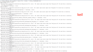

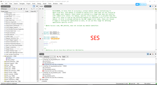

I use keil or SES to compile the example(nRF5_SDK_17.0.2_d674dde\examples\multiprotocol\ble_ant_app_hrm\pca10040\s332). There are some errors occurred as shown in the following figure.
Hi
Please follow the instructions given in the "Running ANT examples" section of the SDK getting started guide to set up your first ANT project.
