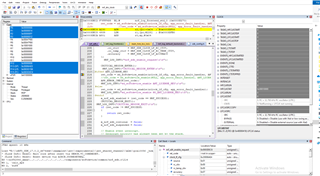

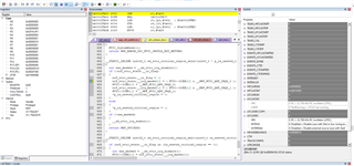

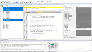

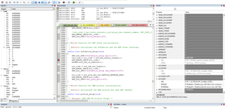

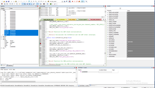

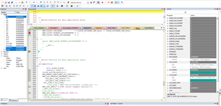

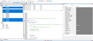

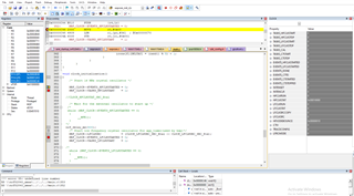

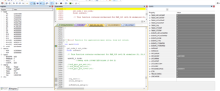

    I can run that snippet,
    but only RC clock are running
    screen shot on register LFCLKSTAT and HFCLKSTAT

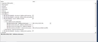

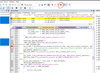

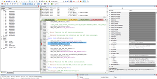

    Will it work with softdevice ?
    I'm not using softdevice now...
    use this snippet then softdevice init ? is that possible ?
