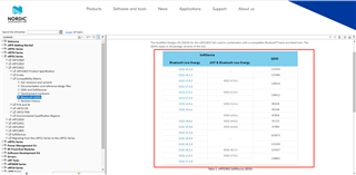

       1、 The following table does not indicate whether the QDID belongs to 5.1 or 5.2.Are the QDIDs of softdevice classified as Bluetooth 5.1 or 5.2?

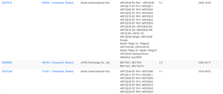

       2、The following qdid is found on the SIG official website.but nrf52832 is Bluetooth 5.2 SOC,The customer doesn't know whether to fill in Bluetooth 5.1 or 5.2 in the Bluetooth certification  form.
