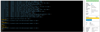

I'm trying to run an example in which is in below link but seems something is missing in  the documentation seems also all commands returns "OK" but no response from GPS.
I run the SLM exactly as in below link using the latest nRF connect release.Please see attached screen shot where there is not GPS answer.
Please instruct how to debug that.

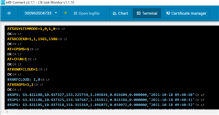

  • Hi Brian,
    GPS is indeed works outside ! thanks Slight smile
    When I try to run AGPS it get and error for 2 last commands. Any ideas what could be an issue?
    I also tried to enable "CONFIG_SLM_AGPS" in prj.conf but it doesn't help.
    Any ideas? what more should be done or maybe something missed in the document of the example?

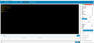

  • Hi Brian,
    CONFIG_NRF_CLOUD_LOG_LEVEL_DBG is no available in SLM app. but only in Asset_tracker.
    I tried to add this config and set it "y" . I'm adding the log file but seems like no verbose data is added and everything looks like previously.
    Israel
    I checked that. I got an error. Seems like "AT#XNRFCLOUD" commands doesn't work at some conditions.
    Full log will send you separately
    Israel
  • Hi Israel,
    It's just check if your issues comes from mqtt certificate on nRF Cloud or not and I can confirm that it does . More guide will be handled by mail or call tomorrow.
    //Brian
    [updated 28th of October]
    confirmed it worked out after deleting the DK which has added on nRFCloud.
    Please close this case and open a new one if you have further issues. Thanks for your patience.
