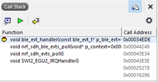

    From the log we only see that you get BLE event 0x11, which is BLE_GAP_EVT_DISCONNECTED, but not why. Can you print the disconnect reason?
    I am not sure how to print the reason on the application, could track only the event from the Soft Devices using a breakpoint:
    Also, is there a better way to see the reasons from the SD events?
    pedrovfr_LNNano said:
    Does it means the peer is disconnecting?
    Yes, you see here that the local host terminated the connection (which refers to the Android device in the Android log). On the nRF side I expect you see that the remote user terminated the connection. I do not believe you can do anything about this on Android (or iOS) devices.
    Yes. When  you get the BLE_GAP_EVT_DISCONNECTED you can check the reason and print it for instance like this:
                NRF_LOG_INFO("Disconnected, reason %d.",
                              p_ble_evt->evt.gap_evt.params.disconnected.reason);
    The number get here represents a standard Bluetooth status code.
