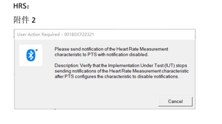

when we used nRF52805 for BQB certification, an error occurred to Heart Rate Service as shown in the figure. Why does this prompt appear?

From the logs you have provided it looks like the No or cancel was pressed on the pop up action required box and that results in a FAIL

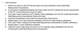

From the HRS.TS doc there are some procedures for the test.
Are repeating the steps like suggested in the test procedure?
If you are not able to resolve the issue could you provide a sniffer trace of when such a test is preformed. This will provide more information that can be used to follow the chain of events more carefully an might shad some light on the resulting issue.
