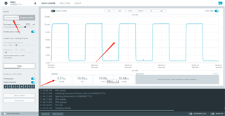

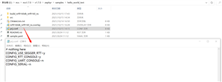

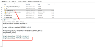

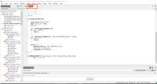

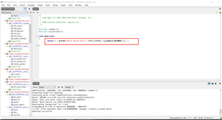

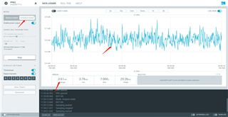

    1、I made the following modifications to the hello_world example(ncs1.7.0\v1.7.0\zephyr\samples\hello_world.

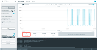

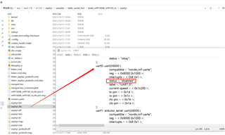

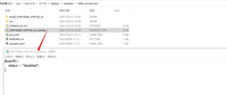

2、I have disabled uart0,But the average power consumption is 6.15mA,I don't know whether the power consumption is normal.This is the power consumption I measured with the source meter mode of ppk2.DK's External supply + to the PPK2 VOUT pin, DK's External supply - to the PPK2 GND pin.

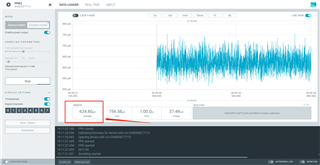

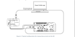

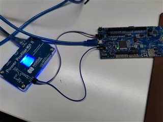

3、By the way, the value measured in the ampere meter mode of ppk2 is different from that measured in the source meter mode,The connection of ppk2 and 9160kd is shown in the figure below,and Sb34 has been cut off.
