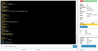

    When I running  at_client demo, the LTE Link Monitor shows
    and the log :

    It shows that the network is working.
