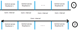

  • Ok, I think I got it. Also I think I figured out one more misconception of mine. I thought that in case of multiple peripherals the central serves only one device per connection interval and then the next peripheral on the next connection interval and so on. But from your explanation I understand that the central tries to serve all peripherals in one connection interval. I thought that graph 1 was correct while graph 2 is the correct one
  • Also, How can I activate the Connection Event Length Extension?
  • Nice illustration, your understanding is correct.
    Kenneth
  • The connection event length extension will have no effect in this case, it will only adjust the amount of time that should be allocated locally,  it will have no effect on the peer (phone).
    Kenneth
