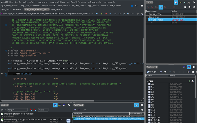

  • Thanks for the help. I have tried adapting this example to the nRF52811, without success so far. I think the problem is in the APP_UART_FIFO_INIT function, but can't even debug it correctly, because there is a call to the app_error_handler funcion and NRF_BREAKPOINT_COND is activated. It's probably a vague problem description, but that's what I know so far...

    I see. What did you do to debug? The APP_UART_FIFO_INIT() essentially created two static buffers, and then calls app_uart_init(). If there is an issue, that should return an error code.
    If I am correct, it appears to occur when app_uart_get() is called. Then uart_event_handler is called, which in turn calls app_error_handler_bare. Depending on the breakpoints I use, app_error_handler_bare receives an error code of either 0x00000004 or 0x0000000c, which according to nrf_error.h correspond to "No Memory for operation" and "Data size exceeds limit" respectively.

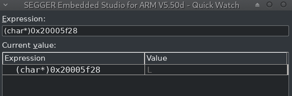

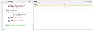

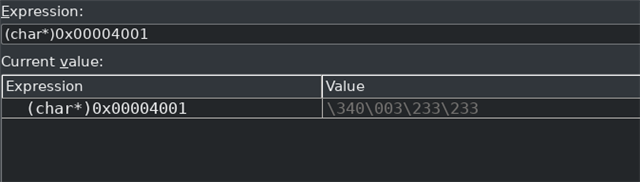

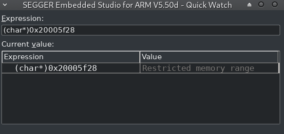

  • If I enable the DEBUG flag, app_error_handler function is called. It has an error code, a p_file_name and line_num, how can I interpret the hexadecimal value of p_file_name to locate the error?
    p_file_name is a pointer to a string that shows the file name where the error was detected by an APP_ERROR_CHECK. If you enable logging it is printed directly. If not, you can inspect it with a debugger. Remember to first make a debug build as that makes this much easier (the C code you see then matches the machine code). Then inspect for instance like this if using SES:
    1. Add p_info to watch
    2. Read the value of p_file_name wihin p_info
    3. Type inn (char*)<value of p_file_name> as an expression
    then you can read the value of the string like this:
