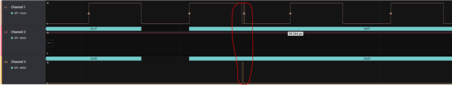

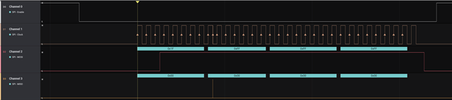

Cannot Read MAX30003WING Board using SPI communication
I tried to check SPI communication with a test board.
However, I couldn't read the device info from the max30003wing board.
Board: NRF52840DK --> MAX30003WING Using SPI.
SDK: nRF5_SDK_17.1.0_ddde560
this is my code

I don't know what is wrong. Is the problems with the SPI read function?
Please any help is appreciated.
