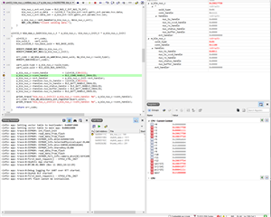

    What is happening is that when I run this line of code:  p_ble_nus_c->conn_handle = (uint16_t)0x1111; it does not set the conn_handle to 0x1111, it sets it to 0x0011 and also sets part of the nus_tx_handle when this instruction is executed.  I have attached a screen shot of the debugger showing this.
    This started happening after I pulled the SMP implementation from the dev board project to our real project.  Our real project was based on a SDK that did not contain the GAT QUEUE stuff, i.e., nrf_ble_gq.c and nrf_ble_gq.h.  I therefore copied these file from the 17.1SDK into our real project.  I then had to replace the nrf_queue.c and nrf_queue.h in our real project with the files from the 17.1SDK to get the project to build.  The SMP service stuff is now working in our real project.

    And then look at the p_config variable which should be filled with NRF_DRV_WDT_DEAFULT_CONFIG but it is not.  I have attached a debug screen showing this below.
    If after entering the nrfx_wdt_init function I stop at a breakpoint and  adjust the p_config  data values to be those of NRF_DRV_WDT_DEAFULT_CONFIG Before NRFX_IRQ_PRIORITY_SET(WDT_IRQn, p_config->interrupt_priority); is called then I do not get a crash.   This is similar to the first problem, the compiler seems like it is messing things up.
    I am guessing that this may have been caused by adding in the SMP stuff to our real project since it did not happen prior to that.  I have been beating my head against a wall all day trying to make sense of this.  I am really hoping that you have some ideas.
