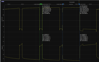

We are using nRF9160 and have a rare issue with a very high current consumption from the battery. We are using lithium-thionyl chloride 3,6V batteries, three in parallel.
Here is the picture of one of these events: 400mA pulses of 250ms duration, inbetween 60mA consumption of 35ms.

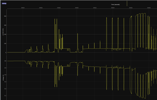

This event happens very rarely e.g. 1 time per 10 hours but is still repeatable. It begins as a common transmission procedure, where the energy can be delivered from the supercap we are using. But then as it is discharging, energy starts to be delivered from the battery, causing voltage drops down to 3,0V.
The same event could be simulated by challenging the device by dropping RSRP values lower than 20. But during this observation RSRP values are always good >40. We checked also if there is any relationship to BS-change and could not exactly determine that.
Do you have any ideas what can be the reason for that?
Does it look familiar to anybody, maybe not particular values but the shape of curves?
