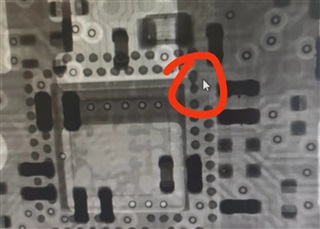

Enable nRF52840 regulator DC/DC mode with short-circuit in DCC and DEC4
I am searching for some methods to blocking the abnormal PCBAs which got short-circuit in DCC and DEC4 after SMT process. These abnormal PCBAs will cause BT pairing process fails in business firmware stage, however it is not efficient for manufacturing to use this method to block them out. I try to have these PCBAs to go through the DTM test with enabling the regulator DC/DC mode, but sometimes pass and sometimes fail. Is there any suggestion for me? Thank you!
