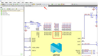

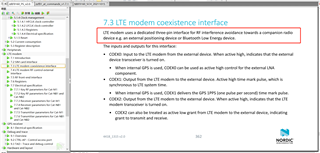

What is COEXx use for?
Hi
          What is COEXx use for,Is it necessary to reserve in product design?
