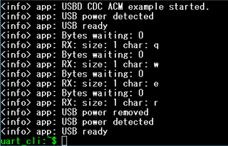

  • Hi
    Do you not get log data in the ACM0 terminal?
    You should get something like this when running the example (in this case I first connect the USB, then send four characters through the USB CDC comport, and then I remove and reconnect the USB again):
    If you want you can also redirect logging to another interface, such as RTT. Then you will not depend on the UART console for logging information, but can use the debug interface instead. To view the RTT log you need to use the J-Link RTT Viewer application, and enable RTT logging by setting NRF_LOG_BACKEND_RTT_ENABLED 1 in sdk_config.h, while setting NRF_CLI_LOG_BACKEND 0.
