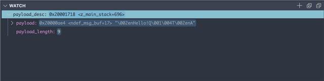

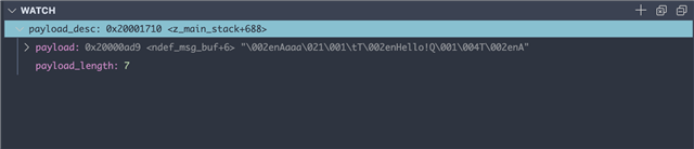

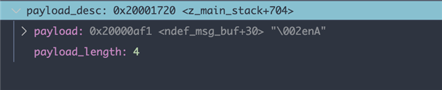

I'm trying to read the NDEF records stored on my NRF52 DK but I'm having some issues when the the NDEF record payload is less than 4 chars. I just get random symbols or large buffer values instead (See terminal output):

    int payload_length = payload_desc->payload_length - 3;
    char *payload_message = malloc(payload_length + 1);
    char *original_message = payload_desc->payload + 3;

    It shouldn't be necessary to remove the header by subtracting 3 as payload_desc->payload_length variable contains the actual payload length without the header. You also don't need to add 3 for original_message pointer as it already points at the start of the payload.
    The SDK parsing functions should parse it correctly regardless if "record length" field is 4-byte or 1-byte record.
    regards
    Jared
