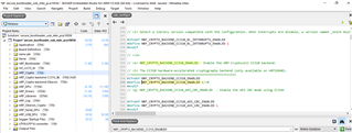

    I have disable the nrf_crypto frontend and enable crypto backend.

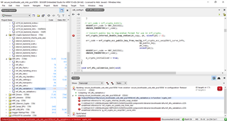

    Then got some error related nrf_crypto function witch is available in nrf_dfu_validation.c.

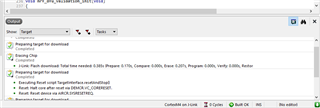

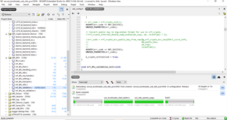

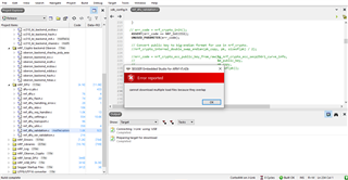

    As of now i have commented those functions just for error removal and i am trying to flash the code in nrf52833 but while flashing we getting some error too.
    This error is related to flash and RAM?

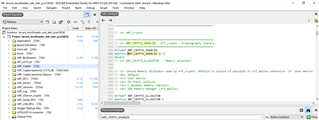

    This is not exactly right. You still need nrf_crypto as this is used by the bootloader to validate upgrade images, so NRF_CRYPTO_ENABLED must be 1. However, you need to disable the CC310 BL backend which is used by the bootloader projects for nRF52840, so set NRF_CRYPTO_BACKEND_CC310_BL_ENABLED to 0 in sdk_config.h. Now, you need to enable other backends. I suggest you refer to an example bootloader project for any non-nRF52840 device. There you can see that you need to set NRF_CRYPTO_BACKEND_MICRO_ECC_ENABLED to 1 and NRF_CRYPTO_BACKEND_MICRO_ECC_ECC_SECP256R1_ENABLED to 1. You also need to set NRF_CRYPTO_BACKEND_NRF_SW_ENABLED to 1 and NRF_CRYPTO_BACKEND_NRF_SW_HASH_SHA256_ENABLED to 1.
    That is because you disabled nrf_crypto in sdk_config.h, and that way these functions that yuo rely on are removed by the preprocessor. This should be OK after you fix your sdk_config.h as described.
    We need to look at your memory layout in order to understand this. Perhaps the bootloader start address is wrong and overlaps with the SoftDevice? Which start address have you specified for the bootloader?
    This is related to flash.
