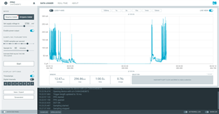

I am using the ppk II, and I have had a number of occasions where the current displayed on the PC suddenly disappears (see attached). The voltage to the DUT seems to be maintained though because the DUT continuous to function. First I thought that I had moved the USB cable and somehow created a disconnection from the computer, but since the supply to the DUT is maintained that can't be the case. Any suggestions?

  • It seems it happens when I leave the profiler window (running) and go to another program (mail, chrome etc). If I am away for a few minutes and then return to the profiler window the trace seems to have stopped. I wait for a while, and then if I press "stop" and then "start" I don't get the trace back. I have to restart. This happens every time. I also noticed that if I have the profiler running in the background and keep the new window (e.g. browser) not in full window mode, so I still can see the profiler running in the background it is kept alive.
