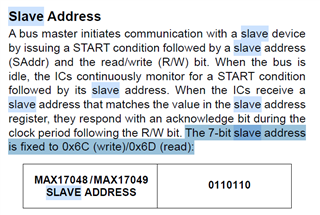

  • The address is 0x36,
    #define MAX1704x_ADDRESS 0x36 // Unshifted I2C address. Becomes 0x6C for write and 0x6D for read.

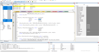

  • I wrote for WRITE :
    //WRITE TO 0xFE REGISTER ON MAX17408 (CMD) BEGIN
                      buffer_tx[0] = 0xFE;
                        buffer_tx[1] = 0x54;
                        buffer_tx[2] = 0x00;
                    ret = nrf_drv_twi_tx(&m_twi_master_MAX17048, 0X36, buffer_tx, 3, false);
    how can I write for READ ?
