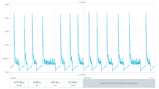

The baseline current consumption running the azure_iot_hub is very high.
I'm using nRF Connect SDKv1.6.1. The sample connects and sends data to azure as expected. But when looking at the current consumption it's way too high. I first observed this on a custom board, and then exactly the same on nRF9160DK. Current is measured using PPK2.
What causes these peaks? How can I remove them?
The azure_iot_hub sample is unmodified except for configuring the azure address and TLS sec
