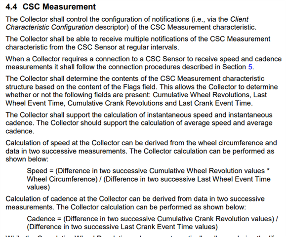

I checked GATT spec. supplement V5 document, it supports 3 features:
1.wheel revolution data supported
2.crank revolution data supported
3.multiple sensor locations supported
In crank revolution data support, I just found 2 flags:
1.Cumulative Crank Revolutions
2.Last Crank Event Time
How make it can output instantaneous cadence data to my device? just like android phone (app: nRF connect)?

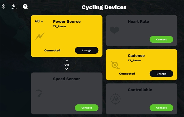

    What do you mean by output? You want to print the value over UART ? or send the data more frequently over BLE ?
  • Hi, Sigurd,
    Thanks for your reply.
    I means I need to send the instantaneous cadence data (RPM) just like I set up a cycling cadence sensor on bike and connect it to my android apps.
    Makes app (Wahoo, Rouvy or others...) can receiving the RPM data correctly.
    TT_Power is what I named to my nRF52-DK TX device, you can see it when I connected to this app (Rouvy).
    App can receiving the instantaneous power data in 60W, but no instantaneous cadence data (that what I need).
