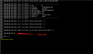

I use RTT to output log data, but I found that it can only output about 1k characters each time. Where can I modify it?
this my config about log
CONFIG_LOG=y
CONFIG_USE_SEGGER_RTT=y
CONFIG_LOG_BACKEND_RTT=y
CONFIG_LOG_BACKEND_UART=n
CONFIG_CONSOLE=n
CONFIG_RTT_CONSOLE=n
CONFIG_UART_CONSOLE=n
CONFIG_LOG_DEFAULT_LEVEL=4
CONFIG_LOG_MODE_OVERFLOW=y
CONFIG_LOG_BACKEND_SHOW_COLOR=n
CONFIG_LOG_BACKEND_FORMAT_TIMESTAMP=y
CONFIG_SEGGER_RTT_BUFFER_SIZE_UP=4096
Thank you for all your assistance.

  • Hi Håkon,Thank you very much for your reply
    I modified them separately according to your suggestions, but it didn’t seem to work
    I did a more detailed test and found that only the first packet of data when the 9160 is turned on will be like this,all subsequent data are complete.
    And I use the serial port to output log data, and there is no such problem at all.
    It feels like a problem with RTT.
