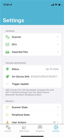

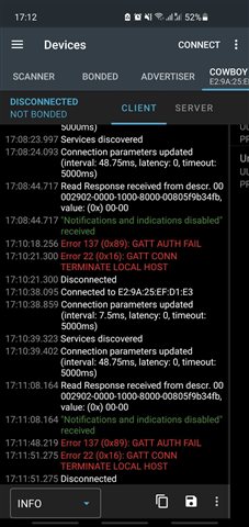

Nordic connect application does not always trigger pairing flow when reading out secure characteristic
Using the NRF connect app we can simulate the problem we have in our app Cowboy. Some customers cannot pair with the bike that uses the nRF52840. We have secure and non secure characteristics. Normally to trigger the pairing and entering the static pairing key we read out a secure characteristic. Using the NRF connect app we can do this with most of the products only some respond with authentication failed.
So why does this not trigger the pairing again?
The software versions that we are using is
  • SDK 17.0.2
  • Soft device S140 7.2.0
Workaround is that when we are stuck in this state the soft device keeps responding that authentication is needed when reading out a secure characteristic but does not trigger the pairing flow on the OS. We are however able to do a DFU update as that is not secured, or better secured different. After the DFU update the device seams to have been reset and the pairing is triggered correctly on the OS when reading out a secure characteristic.
Could this be a bug in the soft device? It should recover from the authentication needed by forcing the OS to start the pairing flow no?
Conclusion
This happens in the Nordic connect application on both iOS and Android so we are now implementing a reset on a timeout if we are stuck in this state. But could you investigate why this is occurring?

    UPDATE: One thought is that one of the devices have the pairing information stored already in the flash, which will cause trying to pair yet again to fail. Can you try deleting bonding information on both devices when this occurs and see if that fixes the issue?
  • We found another bike stuck in this situation. We now assume that the flash is full. Problem is if we connect the debugger the device is reset and the problem is not longer there.
    I did manage to have debug logs via the nRF connect application. They are attached. Do you see anything use-full

    I	11:24:43.933	Bonding failed
    D	11:24:43.984	[Broadcast] Action received: android.bluetooth.device.action.BOND_STATE_CHANGED, bond state changed to: BOND_BONDING (11)
    D	11:24:43.995	[Broadcast] Action received: android.bluetooth.device.action.BOND_STATE_CHANGED, bond state changed to: BOND_NONE (10)
    I	11:24:43.995	Bonding failed
    D	11:24:44.009	[Broadcast] Action received: android.bluetooth.device.action.BOND_STATE_CHANGED, bond state changed to: BOND_BONDING (11)
    D	11:24:44.009	[Broadcast] Action received: android.bluetooth.device.action.BOND_STATE_CHANGED, bond state changed to: BOND_NONE (10)
    I	11:24:44.009	Bonding failed
    D	11:24:44.021	[Broadcast] Action received: android.bluetooth.device.action.BOND_STATE_CHANGED, bond state changed to: BOND_BONDING (11)
    D	11:24:44.037	[Broadcast] Action received: android.bluetooth.device.action.BOND_STATE_CHANGED, bond state changed to: BOND_NONE (10)
    I	11:24:44.037	Bonding failed
    D	11:24:44.037	[Broadcast] Action received: android.bluetooth.device.action.BOND_STATE_CHANGED, bond state changed to: BOND_BONDING (11)
    D	11:24:44.056	[Broadcast] Action received: android.bluetooth.device.action.BOND_STATE_CHANGED, bond state changed to: BOND_NONE (10)
    I	11:24:44.056	Bonding failed
    D	11:24:44.078	[Broadcast] Action received: android.bluetooth.device.action.BOND_STATE_CHANGED, bond state changed to: BOND_BONDING (11)
    D	11:24:44.078	[Broadcast] Action received: android.bluetooth.device.action.BOND_STATE_CHANGED, bond state changed to: BOND_NONE (10)
    I	11:24:44.078	Bonding failed
    D	11:24:44.098	[Broadcast] Action received: android.bluetooth.device.action.BOND_STATE_CHANGED, bond state changed to: BOND_BONDING (11)
    D	11:24:44.105	[Broadcast] Action received: android.bluetooth.device.action.BOND_STATE_CHANGED, bond state changed to: BOND_NONE (10)
    I	11:24:44.105	Bonding failed
    D	11:24:44.114	[Broadcast] Action received: android.bluetooth.device.action.BOND_STATE_CHANGED, bond state changed to: BOND_BONDING (11)
    D	11:24:44.123	[Broadcast] Action received: android.bluetooth.device.action.BOND_STATE_CHANGED, bond state changed to: BOND_NONE (10)
    I	11:24:44.123	Bonding failed
    D	11:24:44.134	[Broadcast] Action received: android.bluetooth.device.action.BOND_STATE_CHANGED, bond state changed to: BOND_BONDING (11)
    D	11:24:44.145	[Broadcast] Action received: android.bluetooth.device.action.BOND_STATE_CHANGED, bond state changed to: BOND_NONE (10)
    I	11:24:44.145	Bonding failed
    D	11:24:44.168	[Broadcast] Action received: android.bluetooth.device.action.BOND_STATE_CHANGED, bond state changed to: BOND_BONDING (11)
    D	11:24:44.168	[Broadcast] Action received: android.bluetooth.device.action.BOND_STATE_CHANGED, bond state changed to: BOND_NONE (10)
    I	11:24:44.168	Bonding failed
    D	11:24:44.172	[Broadcast] Action received: android.bluetooth.device.action.BOND_STATE_CHANGED, bond state changed to: BOND_NONE (10)
    I	11:24:44.172	Bonding failed
    D	11:24:44.190	[Broadcast] Action received: android.bluetooth.device.action.BOND_STATE_CHANGED, bond state changed to: BOND_BONDING (11)
    D	11:24:44.201	[Broadcast] Action received: android.bluetooth.device.action.BOND_STATE_CHANGED, bond state changed to: BOND_NONE (10)
    I	11:24:44.201	Bonding failed
    D	11:24:44.220	[Broadcast] Action received: android.bluetooth.device.action.BOND_STATE_CHANGED, bond state changed to: BOND_BONDING (11)
    D	11:24:44.220	[Broadcast] Action received: android.bluetooth.device.action.BOND_STATE_CHANGED, bond state changed to: BOND_NONE (10)
    I	11:24:44.220	Bonding failed
    D	11:24:44.235	[Broadcast] Action received: android.bluetooth.device.action.BOND_STATE_CHANGED, bond state changed to: BOND_BONDING (11)
    D	11:24:44.235	[Broadcast] Action received: android.bluetooth.device.action.BOND_STATE_CHANGED, bond state changed to: BOND_NONE (10)
    I	11:24:44.235	Bonding failed
    D	11:24:44.246	[Broadcast] Action received: android.bluetooth.device.action.BOND_STATE_CHANGED, bond state changed to: BOND_BONDING (11)
    D	11:24:44.246	[Broadcast] Action received: android.bluetooth.device.action.BOND_STATE_CHANGED, bond state changed to: BOND_NONE (10)
    I	11:24:44.246	Bonding failed
    D	11:24:44.259	[Broadcast] Action received: android.bluetooth.device.action.BOND_STATE_CHANGED, bond state changed to: BOND_BONDING (11)
    D	11:24:44.268	[Broadcast] Action received: android.bluetooth.device.action.BOND_STATE_CHANGED, bond state changed to: BOND_NONE (10)
    I	11:24:44.268	Bonding failed
    D	11:24:44.280	[Broadcast] Action received: android.bluetooth.device.action.BOND_STATE_CHANGED, bond state changed to: BOND_BONDING (11)
    D	11:24:44.290	[Broadcast] Action received: android.bluetooth.device.action.BOND_STATE_CHANGED, bond state changed to: BOND_NONE (10)
    I	11:24:44.290	Bonding failed
    D	11:24:44.290	[Broadcast] Action received: android.bluetooth.device.action.BOND_STATE_CHANGED, bond state changed to: BOND_BONDING (11)
    D	11:24:44.321	[Broadcast] Action received: android.bluetooth.device.action.BOND_STATE_CHANGED, bond state changed to: BOND_BONDING (11)
    D	11:24:44.322	[Broadcast] Action received: android.bluetooth.device.action.BOND_STATE_CHANGED, bond state changed to: BOND_NONE (10)
    I	11:24:44.323	Bonding failed
    D	11:24:44.335	[Broadcast] Action received: android.bluetooth.device.action.BOND_STATE_CHANGED, bond state changed to: BOND_BONDING (11)
    D	11:24:44.346	[Broadcast] Action received: android.bluetooth.device.action.BOND_STATE_CHANGED, bond state changed to: BOND_NONE (10)
    I	11:24:44.346	Bonding failed
    D	11:24:44.363	[Broadcast] Action received: android.bluetooth.device.action.BOND_STATE_CHANGED, bond state changed to: BOND_BONDING (11)
    D	11:24:44.379	[Broadcast] Action received: android.bluetooth.device.action.BOND_STATE_CHANGED, bond state changed to: BOND_NONE (10)
    I	11:24:44.379	Bonding failed
    V	11:24:52.929	Starting pairing...
    D	11:24:52.929	device.createBond()
    D	11:24:52.954	[Broadcast] Action received: android.bluetooth.device.action.BOND_STATE_CHANGED, bond state changed to: BOND_BONDING (11)
    D	11:24:52.966	[Broadcast] Action received: android.bluetooth.device.action.BOND_STATE_CHANGED, bond state changed to: BOND_NONE (10)
    I	11:24:52.966	Bonding failed
    D	11:24:53.002	[Broadcast] Action received: android.bluetooth.device.action.BOND_STATE_CHANGED, bond state changed to: BOND_BONDING (11)
    D	11:24:53.003	[Broadcast] Action received: android.bluetooth.device.action.BOND_STATE_CHANGED, bond state changed to: BOND_NONE (10)
    I	11:24:53.003	Bonding failed
    D	11:24:53.015	[Broadcast] Action received: android.bluetooth.device.action.BOND_STATE_CHANGED, bond state changed to: BOND_BONDING (11)
    D	11:24:53.031	[Broadcast] Action received: android.bluetooth.device.action.BOND_STATE_CHANGED, bond state changed to: BOND_NONE (10)
    I	11:24:53.031	Bonding failed
    D	11:24:53.031	[Broadcast] Action received: android.bluetooth.device.action.BOND_STATE_CHANGED, bond state changed to: BOND_BONDING (11)
    D	11:24:53.044	[Broadcast] Action received: android.bluetooth.device.action.BOND_STATE_CHANGED, bond state changed to: BOND_NONE (10)
    I	11:24:53.044	Bonding failed
    D	11:24:53.053	[Broadcast] Action received: android.bluetooth.device.action.BOND_STATE_CHANGED, bond state changed to: BOND_BONDING (11)
    D	11:24:53.066	[Broadcast] Action received: android.bluetooth.device.action.BOND_STATE_CHANGED, bond state changed to: BOND_NONE (10)
    I	11:24:53.066	Bonding failed
    D	11:24:53.085	[Broadcast] Action received: android.bluetooth.device.action.BOND_STATE_CHANGED, bond state changed to: BOND_BONDING (11)
    D	11:24:53.085	[Broadcast] Action received: android.bluetooth.device.action.BOND_STATE_CHANGED, bond state changed to: BOND_NONE (10)
    I	11:24:53.085	Bonding failed
    D	11:24:53.089	[Broadcast] Action received: android.bluetooth.device.action.BOND_STATE_CHANGED, bond state changed to: BOND_BONDING (11)
    D	11:24:53.099	[Broadcast] Action received: android.bluetooth.device.action.BOND_STATE_CHANGED, bond state changed to: BOND_NONE (10)
    I	11:24:53.099	Bonding failed
    D	11:25:06.750	[Callback] Connection state changed with status: 22 and new state: DISCONNECTED (0)
    E	11:25:06.751	Error 22 (0x16): GATT CONN TERMINATE LOCAL HOST
    I	11:25:06.751	Disconnected
    D	11:25:06.827	[Broadcast] Action received: android.bluetooth.device.action.ACL_DISCONNECTED
    D	11:25:07.093	[Broadcast] Action received: android.bluetooth.device.action.ACL_CONNECTED
    D	11:25:07.093	gatt.close()
    D	11:25:07.094	wait(200)
    V	11:25:07.295	Connecting to F2:73:A4:51:4A:4B...
    D	11:25:07.295	gatt = device.connectGatt(autoConnect = false, TRANSPORT_LE, preferred PHY = LE 1M)
    D	11:25:07.300	[Callback] Connection state changed with status: 0 and new state: CONNECTED (2)
    I	11:25:07.300	Connected to F2:73:A4:51:4A:4B
    V	11:25:07.313	Discovering services...
    D	11:25:07.313	gatt.discoverServices()
    I	11:25:07.767	Connection parameters updated (interval: 7.5ms, latency: 0, timeout: 5000ms)
    D	11:25:08.313	[Callback] Services discovered with status: 0
    I	11:25:08.313	Services discovered

    V	11:27:31.629	Starting pairing...
    D	11:27:31.629	device.createBond()
    D	11:27:31.666	[Broadcast] Action received: android.bluetooth.device.action.BOND_STATE_CHANGED, bond state changed to: BOND_BONDING (11)
    D	11:28:01.661	[Broadcast] Action received: android.bluetooth.device.action.BOND_STATE_CHANGED, bond state changed to: BOND_NONE (10)
    I	11:28:01.661	Bonding failed
    D	11:28:04.682	[Callback] Connection state changed with status: 22 and new state: DISCONNECTED (0)
    E	11:28:04.682	Error 22 (0x16): GATT CONN TERMINATE LOCAL HOST
    I	11:28:04.682	Disconnected
    Android:
    nRF Connect, 2021-10-26
    COWBOY (F2:73:A4:51:4A:4B)
    D	11:24:32.369	[Broadcast] Action received: android.bluetooth.device.action.ACL_CONNECTED
    V	11:24:32.527	Connecting to F2:73:A4:51:4A:4B...
    D	11:24:32.527	gatt = device.connectGatt(autoConnect = false, TRANSPORT_LE, opportunistic = true, preferred PHY = LE 1M) (hidden)
    D	11:24:32.530	[Callback] Connection state changed with status: 0 and new state: CONNECTED (2)
    I	11:24:32.530	Connected to F2:73:A4:51:4A:4B
    V	11:24:32.541	Discovering services...
    D	11:24:32.541	gatt.discoverServices()
    I	11:24:33.026	Connection parameters updated (interval: 7.5ms, latency: 0, timeout: 5000ms)
    D	11:24:33.560	[Callback] Services discovered with status: 0
    I	11:24:33.560	Services discovered
    V	11:24:33.578	Generic Access (0x1800)
    - Device Name [R W] (0x2A00)
    - Appearance [R] (0x2A01)
    - Peripheral Preferred Connection Parameters [R] (0x2A04)
    - Central Address Resolution [R] (0x2AA6)
    Generic Attribute (0x1801)
    - Service Changed [I] (0x2A05)
       Client Characteristic Configuration (0x2902)
    Device Information (0x180A)
    - Manufacturer Name String [R] (0x2A29)
    - Serial Number String [R] (0x2A25)
    - Hardware Revision String [R] (0x2A27)
    - Software Revision String [R] (0x2A28)
    Unknown Service (c0b0a000-18eb-499d-b266-2f2910744274)
    - Unknown Characteristic [N R W] (c0b0a001-18eb-499d-b266-2f2910744274)
    - Unknown Characteristic [N R W] (c0b0a003-18eb-499d-b266-2f2910744274)
    - Unknown Characteristic [N R W] (c0b0a004-18eb-499d-b266-2f2910744274)
    - Unknown Characteristic [N R W] (c0b0a005-18eb-499d-b266-2f2910744274)
    - Unknown Characteristic [N R W] (c0b0a008-18eb-499d-b266-2f2910744274)
    - Unknown Characteristic [N R W] (c0b0a009-18eb-499d-b266-2f2910744274)
    - Unknown Characteristic [N R W] (c0b0a00a-18eb-499d-b266-2f2910744274)
    - Unknown Characteristic [N R W] (c0b0a00b-18eb-499d-b266-2f2910744274)
    Unknown Service (c0b0b000-18eb-499d-b266-2f2910744274)
    - Unknown Characteristic [N R] (c0b0b001-18eb-499d-b266-2f2910744274)
    - Unknown Characteristic [W] (c0b0b002-18eb-499d-b266-2f2910744274)
    Nordic UART Service (6e400001-b5a3-f393-e0a9-e50e24dcca9e)
    - RX Characteristic [W WNR] (6e400002-b5a3-f393-e0a9-e50e24dcca9e)
    - TX Characteristic [N] (6e400003-b5a3-f393-e0a9-e50e24dcca9e)
    Secure DFU Service (0xFE59)
    - Buttonless DFU [I W] (8ec90003-f315-4f60-9fb8-838830daea50)
    D	11:24:33.578	gatt.setCharacteristicNotification(00002a05-0000-1000-8000-00805f9b34fb, true)
    D	11:24:33.579	gatt.setCharacteristicNotification(c0b0a001-18eb-499d-b266-2f2910744274, true)
    D	11:24:33.579	gatt.setCharacteristicNotification(c0b0a003-18eb-499d-b266-2f2910744274, true)
    D	11:24:33.580	gatt.setCharacteristicNotification(c0b0a004-18eb-499d-b266-2f2910744274, true)
    D	11:24:33.580	gatt.setCharacteristicNotification(c0b0a005-18eb-499d-b266-2f2910744274, true)
    D	11:24:33.580	gatt.setCharacteristicNotification(c0b0a008-18eb-499d-b266-2f2910744274, true)
    D	11:24:33.581	gatt.setCharacteristicNotification(c0b0a009-18eb-499d-b266-2f2910744274, true)
    D	11:24:33.581	gatt.setCharacteristicNotification(c0b0a00a-18eb-499d-b266-2f2910744274, true)
    D	11:24:33.581	gatt.setCharacteristicNotification(c0b0a00b-18eb-499d-b266-2f2910744274, true)
    D	11:24:33.581	gatt.setCharacteristicNotification(c0b0b001-18eb-499d-b266-2f2910744274, true)
    D	11:24:33.582	gatt.setCharacteristicNotification(6e400003-b5a3-f393-e0a9-e50e24dcca9e, true)
    I	11:24:33.668	Connection parameters updated (interval: 45.0ms, latency: 0, timeout: 5000ms)
    V	11:24:40.070	Starting pairing...
    D	11:24:40.070	device.createBond()
    D	11:24:40.098	[Broadcast] Action received: android.bluetooth.device.action.BOND_STATE_CHANGED, bond state changed to: BOND_BONDING (11)
    D	11:24:40.127	[Broadcast] Action received: android.bluetooth.device.action.BOND_STATE_CHANGED, bond state changed to: BOND_NONE (10)
    I	11:24:40.127	Bonding failed
    D	11:24:40.142	[Broadcast] Action received: android.bluetooth.device.action.BOND_STATE_CHANGED, bond state changed to: BOND_BONDING (11)
    D	11:24:40.150	[Broadcast] Action received: android.bluetooth.device.action.BOND_STATE_CHANGED, bond state changed to: BOND_NONE (10)
    I	11:24:40.151	Bonding failed
    D	11:24:40.176	[Broadcast] Action received: android.bluetooth.device.action.BOND_STATE_CHANGED, bond state changed to: BOND_BONDING (11)
    D	11:24:40.176	[Broadcast] Action received: android.bluetooth.device.action.BOND_STATE_CHANGED, bond state changed to: BOND_NONE (10)
    I	11:24:40.176	Bonding failed
    D	11:24:40.191	[Broadcast] Action received: android.bluetooth.device.action.BOND_STATE_CHANGED, bond state changed to: BOND_BONDING (11)
    D	11:24:40.207	[Broadcast] Action received: android.bluetooth.device.action.BOND_STATE_CHANGED, bond state changed to: BOND_NONE (10)
    I	11:24:40.207	Bonding failed
    D	11:24:40.231	[Broadcast] Action received: android.bluetooth.device.action.BOND_STATE_CHANGED, bond state changed to: BOND_BONDING (11)
    D	11:24:40.231	[Broadcast] Action received: android.bluetooth.device.action.BOND_STATE_CHANGED, bond state changed to: BOND_NONE (10)
    I	11:24:40.231	Bonding failed
    D	11:24:40.244	[Broadcast] Action received: android.bluetooth.device.action.BOND_STATE_CHANGED, bond state changed to: BOND_BONDING (11)
    D	11:24:40.250	[Broadcast] Action received: android.bluetooth.device.action.BOND_STATE_CHANGED, bond state changed to: BOND_NONE (10)
    I	11:24:40.250	Bonding failed
    D	11:24:40.257	[Broadcast] Action received: android.bluetooth.device.action.BOND_STATE_CHANGED, bond state changed to: BOND_BONDING (11)
    D	11:24:40.258	[Broadcast] Action received: android.bluetooth.device.action.BOND_STATE_CHANGED, bond state changed to: BOND_NONE (10)
    I	11:24:40.258	Bonding failed
    D	11:24:40.274	[Broadcast] Action received: android.bluetooth.device.action.BOND_STATE_CHANGED, bond state changed to: BOND_BONDING (11)
    D	11:24:40.284	[Broadcast] Action received: android.bluetooth.device.action.BOND_STATE_CHANGED, bond state changed to: BOND_NONE (10)
    I	11:24:40.284	Bonding failed
    D	11:24:40.306	[Broadcast] Action received: android.bluetooth.device.action.BOND_STATE_CHANGED, bond state changed to: BOND_BONDING (11)
    D	11:24:40.306	[Broadcast] Action received: android.bluetooth.device.action.BOND_STATE_CHANGED, bond state changed to: BOND_NONE (10)
    I	11:24:40.306	Bonding failed
    D	11:24:40.323	[Broadcast] Action received: android.bluetooth.device.action.BOND_STATE_CHANGED, bond state changed to: BOND_BONDING (11)
    D	11:24:40.323	[Broadcast] Action received: android.bluetooth.device.action.BOND_STATE_CHANGED, bond state changed to: BOND_NONE (10)
    I	11:24:40.323	Bonding failed
    D	11:24:40.342	[Broadcast] Action received: android.bluetooth.device.action.BOND_STATE_CHANGED, bond state changed to: BOND_BONDING (11)
    D	11:24:40.352	[Broadcast] Action received: android.bluetooth.device.action.BOND_STATE_CHANGED, bond state changed to: BOND_NONE (10)
    I	11:24:40.352	Bonding failed
    D	11:24:40.370	[Broadcast] Action received: android.bluetooth.device.action.BOND_STATE_CHANGED, bond state changed to: BOND_BONDING (11)
    D	11:24:40.370	[Broadcast] Action received: android.bluetooth.device.action.BOND_STATE_CHANGED, bond state changed to: BOND_NONE (10)
    I	11:24:40.370	Bonding failed
    D	11:24:40.389	[Broadcast] Action received: android.bluetooth.device.action.BOND_STATE_CHANGED, bond state changed to: BOND_BONDING (11)
    D	11:24:40.389	[Broadcast] Action received: android.bluetooth.device.action.BOND_STATE_CHANGED, bond state changed to: BOND_NONE (10)
    I	11:24:40.389	Bonding failed
    D	11:24:40.411	[Broadcast] Action received: android.bluetooth.device.action.BOND_STATE_CHANGED, bond state changed to: BOND_BONDING (11)
    D	11:24:40.411	[Broadcast] Action received: android.bluetooth.device.action.BOND_STATE_CHANGED, bond state changed to: BOND_NONE (10)
    I	11:24:40.411	Bonding failed
    D	11:24:40.435	[Broadcast] Action received: android.bluetooth.device.action.BOND_STATE_CHANGED, bond state changed to: BOND_BONDING (11)
    D	11:24:40.436	[Broadcast] Action received: android.bluetooth.device.action.BOND_STATE_CHANGED, bond state changed to: BOND_NONE (10)
    I	11:24:40.436	Bonding failed
    V	11:24:43.668	Starting pairing...
    D	11:24:43.668	device.createBond()
    D	11:24:43.693	[Broadcast] Action received: android.bluetooth.device.action.BOND_STATE_CHANGED, bond state changed to: BOND_BONDING (11)
    D	11:24:43.704	[Broadcast] Action received: android.bluetooth.device.action.BOND_STATE_CHANGED, bond state changed to: BOND_NONE (10)
    I	11:24:43.704	Bonding failed
    D	11:24:43.716	[Broadcast] Action received: android.bluetooth.device.action.BOND_STATE_CHANGED, bond state changed to: BOND_BONDING (11)
    D	11:24:43.728	[Broadcast] Action received: android.bluetooth.device.action.BOND_STATE_CHANGED, bond state changed to: BOND_NONE (10)
    I	11:24:43.728	Bonding failed
    D	11:24:43.747	[Broadcast] Action received: android.bluetooth.device.action.BOND_STATE_CHANGED, bond state changed to: BOND_BONDING (11)
    D	11:24:43.758	[Broadcast] Action received: android.bluetooth.device.action.BOND_STATE_CHANGED, bond state changed to: BOND_NONE (10)
    I	11:24:43.758	Bonding failed
    D	11:24:43.769	[Broadcast] Action received: android.bluetooth.device.action.BOND_STATE_CHANGED, bond state changed to: BOND_BONDING (11)
    D	11:24:43.780	[Broadcast] Action received: android.bluetooth.device.action.BOND_STATE_CHANGED, bond state changed to: BOND_NONE (10)
    I	11:24:43.780	Bonding failed
    D	11:24:43.792	[Broadcast] Action received: android.bluetooth.device.action.BOND_STATE_CHANGED, bond state changed to: BOND_BONDING (11)
    D	11:24:43.803	[Broadcast] Action received: android.bluetooth.device.action.BOND_STATE_CHANGED, bond state changed to: BOND_NONE (10)
    I	11:24:43.803	Bonding failed
    D	11:24:43.825	[Broadcast] Action received: android.bluetooth.device.action.BOND_STATE_CHANGED, bond state changed to: BOND_BONDING (11)
    D	11:24:43.825	[Broadcast] Action received: android.bluetooth.device.action.BOND_STATE_CHANGED, bond state changed to: BOND_NONE (10)
    I	11:24:43.825	Bonding failed
    D	11:24:43.832	[Broadcast] Action received: android.bluetooth.device.action.BOND_STATE_CHANGED, bond state changed to: BOND_BONDING (11)
    D	11:24:43.841	[Broadcast] Action received: android.bluetooth.device.action.BOND_STATE_CHANGED, bond state changed to: BOND_NONE (10)
    I	11:24:43.841	Bonding failed
    D	11:24:43.851	[Broadcast] Action received: android.bluetooth.device.action.BOND_STATE_CHANGED, bond state changed to: BOND_BONDING (11)
    D	11:24:43.876	[Broadcast] Action received: android.bluetooth.device.action.BOND_STATE_CHANGED, bond state changed to: BOND_NONE (10)
    I	11:24:43.876	Bonding failed
    D	11:24:43.876	[Broadcast] Action received: android.bluetooth.device.action.BOND_STATE_CHANGED, bond state changed to: BOND_BONDING (11)
    D	11:24:43.892	[Broadcast] Action received: android.bluetooth.device.action.BOND_STATE_CHANGED, bond state changed to: BOND_NONE (10)
    I	11:24:43.892	Bonding failed
    D	11:24:43.906	[Broadcast] Action received: android.bluetooth.device.action.BOND_STATE_CHANGED, bond state changed to: BOND_BONDING (11)
    D	11:24:43.915	[Broadcast] Action received: android.bluetooth.device.action.BOND_STATE_CHANGED, bond state changed to: BOND_NONE (10)
    I	11:24:43.915	Bonding failed
    D	11:24:43.933	[Broadcast] Action received: android.bluetooth.device.action.BOND_STATE_CHANGED, bond state changed to: BOND_BONDING (11)
    D	11:24:43.933	[Broadcast] Action received: android.bluetooth.device.action.BOND_STATE_CHANGED, bond state changed to: BOND_NONE (10)
    V	11:25:08.326	Generic Access (0x1800)
    D	11:25:08.326	gatt.setCharacteristicNotification(00002a05-0000-1000-8000-00805f9b34fb, true)
    D	11:25:08.327	gatt.setCharacteristicNotification(c0b0a001-18eb-499d-b266-2f2910744274, true)
    D	11:25:08.327	gatt.setCharacteristicNotification(c0b0a003-18eb-499d-b266-2f2910744274, true)
    D	11:25:08.327	gatt.setCharacteristicNotification(c0b0a004-18eb-499d-b266-2f2910744274, true)
    D	11:25:08.328	gatt.setCharacteristicNotification(c0b0a005-18eb-499d-b266-2f2910744274, true)
    D	11:25:08.328	gatt.setCharacteristicNotification(c0b0a008-18eb-499d-b266-2f2910744274, true)
    D	11:25:08.328	gatt.setCharacteristicNotification(c0b0a009-18eb-499d-b266-2f2910744274, true)
    D	11:25:08.329	gatt.setCharacteristicNotification(c0b0a00a-18eb-499d-b266-2f2910744274, true)
    D	11:25:08.329	gatt.setCharacteristicNotification(c0b0a00b-18eb-499d-b266-2f2910744274, true)
    D	11:25:08.329	gatt.setCharacteristicNotification(c0b0b001-18eb-499d-b266-2f2910744274, true)
    D	11:25:08.330	gatt.setCharacteristicNotification(6e400003-b5a3-f393-e0a9-e50e24dcca9e, true)
    I	11:25:08.408	Connection parameters updated (interval: 45.0ms, latency: 0, timeout: 5000ms)
    V	11:25:15.195	Refreshing device cache...
    D	11:25:15.195	gatt.refresh() (hidden)
    I	11:25:15.196	Cache refreshed
    V	11:25:15.196	Discovering services...
    D	11:25:15.196	gatt.discoverServices()
    D	11:25:15.203	[Callback] Services discovered with status: 0
    I	11:25:15.203	Services discovered
    V	11:25:15.223	Generic Access (0x1800)

    D	11:26:07.027	gatt.setCharacteristicNotification(c0b0b001-18eb-499d-b266-2f2910744274, true)
    D	11:26:07.027	gatt.setCharacteristicNotification(6e400003-b5a3-f393-e0a9-e50e24dcca9e, true)
    I	11:26:07.103	Connection parameters updated (interval: 45.0ms, latency: 0, timeout: 5000ms)
    D	11:28:04.705	[Broadcast] Action received: android.bluetooth.device.action.ACL_DISCONNECTED
