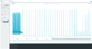

I ran the nrfconnect (ver 3.7.1) in Power Profiler (ver 3.1.3) in BLE advertising.
When I run the source mode on 3000V I get normal peaks  (20mA), however when I run the Ampere mode with the same voltage I see peaks of 45-50 mA.

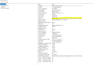

On a different PC (same PS and cable , same nrf version and power profiler version) both Ampere mode and Source mode show the same values (as they should).

  • Looks like the issue is with the USB supply from your computer then, do you have a lot of other devices plugged in to the computer at the same time?
    It might be noise from ground or from a different device connected to the computer, cant really say what exactly is the issue.
    But by using a different power source and suppling through USB power only you are able to get the correct measurements on the "bad" computer. So you have at least a work around at the moment.
    Will do some more pondering on this case and update wit any news, or if you have any more questions feel free to ask.
