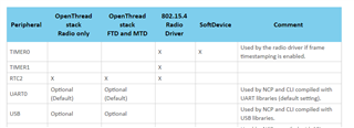

Hello All,
I am using nRF52840 Dev-kit and SDK 4.0 for Zigbee and thread. Due to some functions, we are using SDK 4.0 for this project which is not present in SDK 4.1.
I interfacing the UART0 in my thread example. I am getting the below errors.
"../../../external/openthread/lib/nrf52840/gcc/libopenthread-nrf52840-sdk.a(uart.c.o): in function `UARTE0_UART0_IRQHandler':
multiple definition of `UARTE0_UART0_IRQHandler'; Output/Executable_1 Release External/Obj/nrfx_prs.o:D:\Project\Eurotronics\Thread_Radiator\nRF5_SDK_for_Thread_and_Zigbee_v4.0.0_dc7186b\examples\thread\Thread_VAS_20211024/../../../modules/nrfx/drivers/src/prs/nrfx_prs.c:81: first defined here"
I have used thread MTD as a reference example - I have removed the cli library to make UART free. I have all the procedures to make UART0 free for my application.
Before this I tried to use UART in the freeRTOS_Blinky example and which worked successfully. So I decided to port in thread example. But I am getting the above-mentioned error.
Also, I referred to some nordic forum links regarding the same error, I tried the suggested in sdk_config.h file but still getting the same error.

    I think this issue is with libopenthread-nrf52840-SDK.a library. Because, when tried to include the UART and Openthread step by step. I observed that after adding open thread libraries to the project I got the multiple definition error.
    I need an alternative library file from SDK 4.0. So that I can use UART as well as the open thread library.
