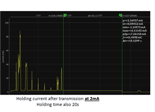

Our modem consumes a lot of current when we use a simcard from a provider 1 (a MNO), much more that when we use a simcard from another provider 2 (a roaming service that uses two MNOs).
For provider 1: The modem sends the data and then consumes a constant 40 mA current for about 20 seconds as shown below.
For provider 2: The modem does not show the same high constant current consumption. It still uses about 20 seconds time, but the consumption now is in spikes instead of a constant consume.
We did not change the default settings of the simcards of both providers. Would you please tell us what can be the reason for that, and how we can enhance that.
Of course we tried that with many simcards, and it it the same difference in behavior, under the same network circumstances.
Provider 1 - eSim:
Provider 2 - eSim:
