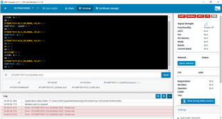

I am testing the %XRFTEST Rx Test Command with the thingy91, with serial_lte_modem_2021-06-28_7a076c22.hex FW
and nRF Connect - LTE monitor software
I used the command AT%XRFTEST=0,1,20,8060,-65,0 for Reception Test and I had an answer from module
%XRFTEST: -27710
OK
then I used the command
AT%XRFTEST=0,1,20,8060,-85,0
and the module does not work with RF commands anymore
I tested CFUN command it seems to work but if I try to use some other RF command as %XRFTEST in Tx,
modules keeps showing an ERROR "Error: 'AT%XRFTEST=0,1,20,8060,-65,0 ' timed out"
So I must turn off the module to make it working again.
  • Hello Catalina,
    crabam said:
    is there another way?
    Please follow the instructions in the documentation and everything will work as expected. Hence, there will be no need to reset the device.
    Velkommen til minicom 2.8
    MULIGHETER: I18n
    Port /dev/ttyACM0, 09:43:48
    Trykk CTRL-A Z for hjelp om spesialtaster
    *** Booting Zephyr OS build v2.6.99-ncs1  ***
    Ready
    [00:00:00.212,066] <inf> slm: Serial LTE Modem
    [00:00:00.249,450] <inf> slm_at_host: at_host init done
    %XRFTEST: -17336
    OK
    AT%XRFTEST=0,0
    OK
    %XRFTEST: -20614
    OK
    AT%XRFTEST=0,0
    OK
    AT%XRFTEST=0,1,20,8060,-50,0
    %XRFTEST: -21557
    OK
    AT%XRFTEST=0,0
    OK
    Markus
