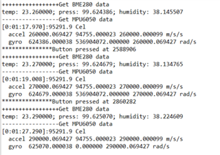

  • My final goal is to get both sensors output when the button is pressed but for now i'm only getting the clock of the button every time it's clicked .Knowing that when the button is clicked the led1 should be disactivated.
    but for now i'm only getting this
    i don't get what need to be done in order to get the other 2 sensors output .
    i did integrated their code in my main.c
    but i believe that something need to be added or edited in order to get the output of the MPU6050 and the BME280.
    Infact, i need to create a functional loop : the main idea is, when i click the button the information of the sensors need to be displayed .
    click the button ->get the output that I posted in the photo below + the output of the MPU & BME + the Led which gets disactivated when the button is clicked
    but for now I'm getting the button pressed output and the Led disactivated when it's pressed
    so can you please help me get this displayed please
    Because i tried Multiple changes but unfortunately i didn't succeed
    i'm seeking help from u please
    and i'm very thankful for all of our responses

  • commun25nov2021.zip
    Test the following sample. I added a work queue, such that you can offload the sensor reading when the button is pressed
    Get the sensor data from the functions get_mpu6050_data_work_fn and get_bme280_data_data_work_work_fn. (run the sensor_sample_fetch and sensor_channel_get functions inside work queue functions).

  • Thank u Simon,
    you help was really appreciated
    and i succeeded to display thanks to added the work queue
    here's a capture from my final result
