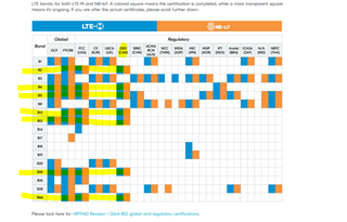

    The nRF9160 supports the following bands according to our product specification:
    • Cat-M1: B1, B2, B3, B4, B5, B8, B12, B13, B14, B17, B18, B19, B20, B25, B26, B28, B66
    • Cat-NB1/NB2: B1, B2, B3, B4, B5, B8, B12, B13, B17, B19, B20, B25, B26, B28, B6
     Certification for nRF9160 is completed for the areas are shown in below table . You can find in this link as well- nRF9160 global certifications - nordicsemi.com
    It seems like B2,B4,B5,B12,B13,B25 and B66 should work in Canada according to the attached table. Though other factors could also work here depending on how telco service providers operating on allocated frequency band. Could you please contact the telco service providers (Hologram and ibasis) to know which band they are operating on under specific Network type?
