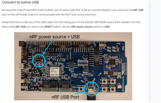

    From your second link, right? Did it say anything after this? Did it build successfully? After you programmed it using nrfjprog, did you change the USB to the USB peripheral port on the DK?

    And yes, I changed the USB peripheral.
