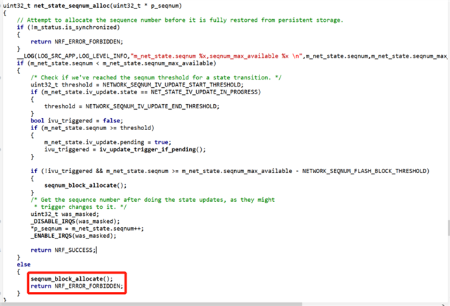

Customer tested mesh SDK4.2, and now had one question:
their product is end node, and once button pressed, MCU is waked up and  send the message to server.which looks like ----reset and button press.
after a long time, find out the sequence number reaches 0xFFFFFF, and net_state_seqnum_alloc api will return NRF_ERROR_FORBIDDEN as below.
Even after reset, it still fails, how to solve this problem.
William.
    In the issue above they are seeing a sequence number exhaustion.
    You can try one or more of the following:
    Decrease NETWORK_SEQNUM_FLASH_BLOCK_SIZE (this will increase the use of flash, but low or no effect if it is frequent resets. This shouldn't be much bigger than a value that you expect to be used up as one approaches the next reset)
    Decrease IV_UPDATE_TIMEOUT_PERIODIC_SAVE_MINUTES(This will increase the use of flash.It should be lower than expected uptime between resets).
    Decrease NETWORK_MIN_IV_RECOVERY_INTERVAL_MINUTES (You won't be able to qualify as this will break the specification).
    Turn on test mode so you can do IV Update whenever (You won't be able to qualify as this will break the specification).
    Also, take a look at this thread for more info.

    i tested it and changed
     change NETWORK_SEQNUM_FLASH_BLOCK_SIZE  to 20,
     and      NETWORK_SEQNUM_FLASH_BLOCK_THRESHOLD to 10,
    each time device goes to system off, and wake up, sequence number will be updated. so it will not reach FFFFFF in her lifetime.

  • Just remember that with smaller value of NETWORK_SEQNUM_FLASH_BLOCK_SIZE will result in a reduced lifetime for the flash. As mentioned this value shouldn't be much bigger than a value that you expect to be used up as one approaches the next reset.
