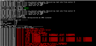

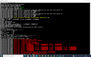

    So after after if I trigger modem_configure(); to connect to LTE then error was thrown which is given below:
    The modem is already connected, so there is no need to run modem_configure(). Just let the carrier_lib take care of the connection till it's done, no need to handle it separately.
    I have commented modem_configure() in code, but still I am facing Hard Fault. Also, I am not sure why there is fs_nvs debug info repeated two times on console.
    Chetan
  • It would be nice if you could share the code, or a sample that I can use the reproduce the issue.
    I have fixed the issue of Bus Fault and I hope LwM2M carrier library is integrated properly because I could see below EVENTS are running once device is flashed.
    Can you please confirm is it working or let me know is there any way to check the LwM2M carrier library integrated with the code successfully ?
