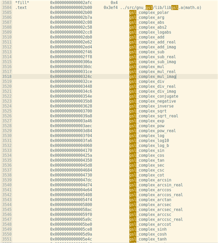

I am working with nRF52833 DK with nRF Connect SDK. All was going great until I had to add a GNU GSL library. I need it because I need matrix multiplications with complex numbers and eigen decomposition of matrices. When I added the the library code size exceeded FLASH size for 10 KB with linker error: arm-none-eabi/bin/ld.bfd: zephyr/zephyr_prebuilt.elf section `rodata' will not fit in region `FLASH'; arm-none-eabi/bin/ld.bfd: region `FLASH' overflowed by 10800 bytes.
So I started throwing code out that was not necessary (like printk), I minimized string constants of necessary printk statements, I used function for repeating code and used smaller data types (float instead of double and uint8_t instead of uint32_t). I managed to save 2.7 KB of code. But that is not enough. But I managed to get the code working with just excluding one of GSL functions that is less necessary. That gave me motivation so I took closer look at generated code.
 I checked the generated zephyr.map file to see which functions take most of the space. I saw that some GNU GSL functions that I was clearly not using (and I am pretty sure that functions that I used do not use them) were compiled too. Like the ones in the provided screenshot. Functions like matrix multiplications for all possible types of matrices were included and I just used one of them. Including all this functions in the build is clearly why my code size exceeds FLASH size. I also included output of ninja rom report.

Is this because I cross-copiled GNU GSL library beforehand and I just included it in CMake build process or I just included library wrong in CMake build process? How can I get rid of these extra functions that eat my FLASH size? I cross-copiled GNU GSL library with command: ./configure --prefix=$HOME/opt/GNU_GSL_ARM_COMPILED --build=x86_64-unknown-linux-gnu --host=arm-none-eabi --target=arm-none-eabi CFLAGS="--specs=nosys.specs -mcpu=cortex-m4 -mthumb -mfloat-abi=hard -mfpu=fpv4-sp-d16". Below is included CMakeLists.txt file for how I included library in CMake process. Library is positioned in project_dir/src/gnu_gsl directory.

  • You could try to set CONFIG_SIZE_OPTIMIZATIONS in your project configuration, as described here.
    Thanks for that. Unfortunately this method did not show any effect on size of code in my example.
    Here is the output with commented function calls for GNU GSL:
    In case I include the library than this output is not present as errors are displayed. In this case I get error "region `FLASH' overflowed by 10800 bytes".
  • Hi
    If that is the case the GNU GSL library alone needs more than 400kB of flash...
    I asked for some input from the software developers, but they didn't have any good suggestions either. The linker should remove any unused functions automatically, so if it still doesn't fit in flash there isn't much you can do.
