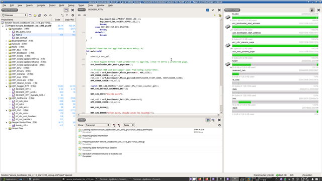

So, we are loading the stock SDK ver 17.0.2 example project
../src/Nordic/examples/dfu/secure_bootloader/pca10100_s113_ble_debug/ses/
with the uECC library compiled into it.  We create a .zip of our firmware using nrfutil.
This was the output:

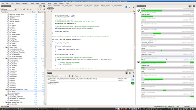

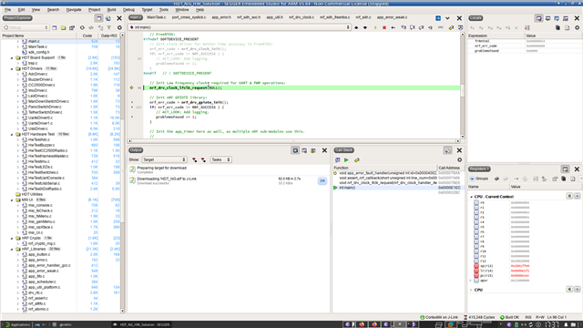

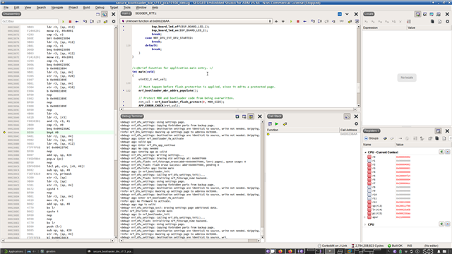

Once we run our own code, we hit what appears to be an assert.  We can't debug into it well since we are running just the dfu example project in the jlink debugger and once the OTA FW is successfully loaded, we don't have symbols for jumping into our own code.  We have looked at issue: https://devzone.nordicsemi.com/f/nordic-q-a/13589/dfu-and-bootloader-debugging and it seems like we might have a similar clock issue.  We have tried to surround the potential double clock init with an #ifdef.  See screen shot of code that may be part of the problem beyond the solution from the previous link.
This is a screen cap of the disassembly and debug output leading up to and after the crash a more full transcript is attached as a text file so you can see the beggining:
Notes: SOFTDEVICE_PRESENT, no nRF clock init:

<debug> nrf_dfu_ble: BLE transpo<info> app: Inside main
<debug> app: In nrf_bootloader_init
<debug> nrf_dfu_settings: Calling nrf_dfu_settings_init()...
<debug> nrf_dfu_flash: Initializing nrf_fstorage_nvmc backend.
<debug> nrf_dfu_settings: Using settings page.
<debug> nrf_dfu_settings: Copying forbidden parts from backup page.
<debug> nrf_dfu_settings: Destination settings are identical to source, write not needed. Skipping.
<info> nrf_dfu_settings: Backing up settings page to address 0x7E000.
<debug> app: Enter nrf_bootloader_fw_activate
<debug> app: Valid App
<debug> app: Enter nrf_dfu_app_continue
<debug> app: No copy needed
<debug> app: Setting app as valid
<debug> nrf_dfu_settings: Writing settings...
<debug> nrf_dfu_settings: Erasing old settings at: 0x0007F000
<debug> nrf_dfu_flash: nrf_fstorage_erase(addr=0x0x0007F000, len=1 pages), queue usage: 0
<debug> nrf_dfu_flash: Flash erase success: addr=0x0007F000, pending 0
<info> app: No firmware to activate.
<debug> app: App is valid
<debug> nrf_dfu_settings_svci: Erasing settings page additional data.
<debug> nrf_dfu_settings: Erasing old settings at: 0x0007E000
<debug> nrf_dfu_flash: nrf_fstorage_erase(addr=0x0x0007E000, len=1 pages), queue usage: 0
<debug> nrf_dfu_flash: Flash erase success: addr=0x0007E000, pending 0
<debug> nrf_dfu_flash: nrf_fstorage_write(addr=0x0007E000, src=0x20005FEC, len=896 bytes), queue usage: 1
<debug> nrf_dfu_flash: Flash write success: addr=0x0007E000, pending 0
<debug> app: Running nrf_bootloader_app_start with address: 0x00001000
<debug> app: Disabling interrupts. NVIC->ICER[0]: 0x0
But it also seems like there could be some memory use overlap high up in RAM as we look at the memory use of the DFU secure boot app:
Compared to RAM use our custom native HDT app for our HDT (heavy duty tag) hardware.  The DFU app runs fine on our custom hardware till we upload our FW OTA.
Is it possible that there is a stack collision between the DFU code and our custom app code?  The relevant
Stanza in flash_placement.xml (which seems a misnomer as RAM is placed there as well):
<ProgramSection alignment="8" size="__STACKSIZE__" load="No" place_from_segment_end="Yes" name=".stack"  address_symbol="__StackLimit" end_symbol="__StackTop"/>
place-from_segment_end="Yes"
Even though we don't use it yet, should we try to place the softdevice S113 in our custom app so that the memory layout it more similar between our custom app and the secure DFU bootloader app?  Is there anything else we should be aware of in using the debug version of the bootloader app that might be causing this fault?  We have played with having SOFTDEVICE_PRESENT  set and not set in our custom app but that didn't seem to fix things.  We tried pulling the clock init stuff out of our code manually so we didn't get a double init from the softdevice and the FreeRTOS initialization code.  Any other ideas?
