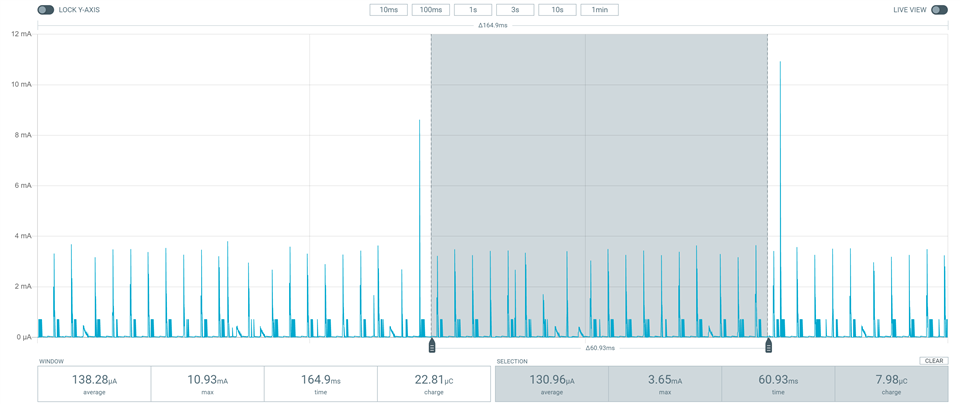

  • Thanks Jared and I am using nrfx_uarte APIs to write my own uart driver.
    Here is what I see on my 840 DK:
    1, DK start up and before nrfx_uarte_init(), average current is 20uA.
    2, After nrfx_uarte_init(), I can read/write uarte properly and average current when there is no data transfer is around 305uA.
    3, Wait 5 seconds without uart data comes in/out, call nrfx_uarte_uninit(). But there is still 135uA current consumption:
    I checked uart_nrf_sw_lpuart() and I think I need to turn off HFXO(high frequency RC oscillator) after uninit uarte, to resume 20uA average power consumption.
    a) Should I using onoff manager to turn off HFXO? As my driver is using nrfx_uarte APIs directly, is there any suggested HAL/driver layer API to turn off HFXO?
    b) Any other suggestions on turn off uart to get the lowest current consumption?
    Anthony Yuan
    Do you turn on the HFXO clock explicitly? If not then the UARTE driver will use HFINT, and disable it automatically when you uninit the driver. In that case the current consumption would be something else.
    Could you post the PPK trace?
