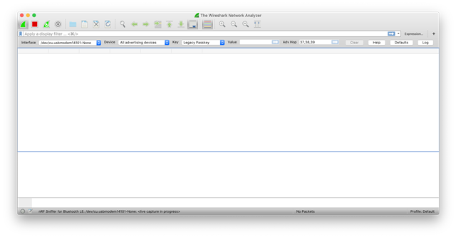

    I installed the nRF sniffer library and added it to Wireshark, and it shows up in the interface list - however, I'm not seeing any advertising traffic. Wireshark reports "<live capture in progress>" in the status bar at the bottom and I'm getting a green flashing activity indicator on the dongle, but no traffic is showing up.
    What's the best way to further debug this? I feel like I must be almost there, but there's one detail somewhere that I'm missing which prevents traffic from showing up in Wireshark.

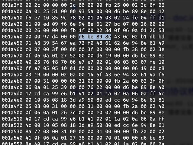

  • Just for some additional context, when I run this directly (from inside Wireshark's extcap directory):
    /usr/local/Cellar/[email protected]/3.9.4/Frameworks/Python.framework/Versions/3.9/Resources/Python.app/Contents/MacOS/Python nrf_sniffer_ble.py --capture --extcap-interface /dev/cu.usbmodem14101-None --fifo /tmp/capdata
    and then tail -f /tmp/capdata | hexdump, I get a large stream of bytes which I believe to be BLE packets, at least based on the fact that I can spot the access address sometimes:
    ....they just never show up in Wireshark for some reason...?
