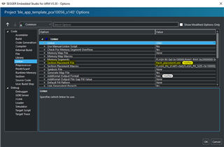

I am trying to import some project built for old version of SDK and SES to the new version of SDK and SES. But I got the error "cannot find run section .log_dynamic_data_run referenced in log_dynamic_data". I reference the post here: https://devzone.nordicsemi.com/f/nordic-q-a/76388/cannot-find-run-section-log_dynamic_data_run-referenced-in-log_dynamic_data/315659#315659, but it does not work for me.
The old project was built for nRF5 SDK 16.0.0, and SEGGER v4.52c. And my current version is nRF5 SDK 17.0.2, and SEGGER 5.60a. My current flash_placement.xml is as follows. Please let me know who to solve the issue. Thank you!

  • Ah, thats the issue. The release note did not say clearly which flash_placement.xml file it is. There are a number of them.
    I was changing $(ProjectDir)/SDK/config/nrf52840/ses/flash_placement.xml. My project actually points to $(ProjectDir)/flash_placement.xml.
