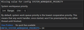

For some reason, VS Code is highlighting negative values in the prj.conf as missing?
Thomas
Hello Thomas,
I see this on my end as well - it definitely seems like it is attributing the 'missing value' error highlight to any negative value in the prj.conf.
I have created an internal ticket on this to have it reviewed by our VS Code developer team.
Thank you for bringing this to our attention!
