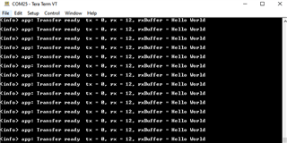

I am current evaluating the SPIS for the nRF52840 and experiencing incomplete transfers from a connected master (Arduino). I'm sending 'hello world'  from the master to the nRF and only receive a few (random) bytes before the NRF_DRV_SPIS_XFER_DONE event is raised The code looks as follows:

The log looks as follows:
00> <info> app: Transfer ready tx = 0, rx = 6, rxBuffer = Hello
00>
00>
00>
00> <info> app: Transfer ready tx = 0, rx = 32, rxBuffer = Hello world
00>
00>
00>
00>
00>
00> <info> app: Transfer ready tx = 0, rx = 5, rxBuffer = Hello
00>
00>
00>
00> <info> app: Transfer ready tx = 0, rx = 2, rxBuffer = He
00>
00>
00>
00>
00>
00>
00> <info> app: Transfer ready tx = 0, rx = 10, rxBuffer = Hello worl
00>
00>
00>
00> <info> app: Transfer ready tx = 0, rx = 0, rxBuffer =
00>
00>
00>
00>
00>
00>
I also checked the SPI signals using a logic analyzer. This seems ok.
