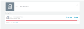

  • Could it be that your SIM is out of data?
    I got a response from iBasis and that is what they said, i quote: "The eSIM in the kit is meant as a test sim card, so you will not be able to connect it over the internet"
    what does that mean for me?

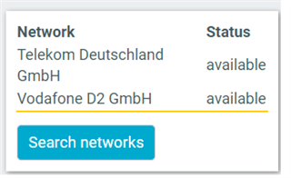

    Could you also query "at+cops?" so I can see which network you're currently connected to?
    Here is what i got:
    AT+COPS=?
    +COPS: (1,"","","26202",7),(1,"","","26201",7)
    OK
    AT+COPS?
    +COPS: 0
    OK
    Screenshot:

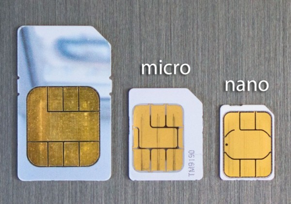

    I am not sure what iBasis means here, you should ask them for a clarification.
    Do you have a solder-able eSIM, or a "normal" nano SIM card like this (ie. the same that comes with the nRF9160 DK)?

    This shows that you have two networks available in your area, but which one were you successfully connected to in the previous log (where it took 20 minutes)?
