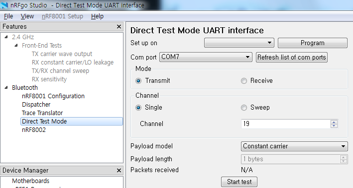

  • Hi.
    If you have any test device that can test the TX power,
    how about trying the DTM (Direct Test Mode) example?
    You can check more details by looking at "Bluetooth Specification V4.0", Volume 6, Part F
    After, downloading the example, connect your board's UART pin with your PC.
    Then run your nRFgo studio.
    DTM
    As described in the picture, you can change channels as you want and test the TX powers.
    Hope this is the thing you are looking for.
    -Regards, Mango922
