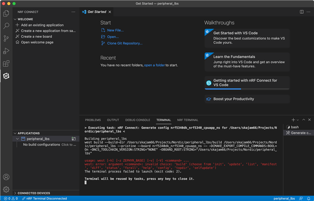

I'm trying to build the peripheral_lbs sample app for the nRF5340 using VS Code and I cannot get past the build configuration stage. Any assistance would be appreciated:

  • Forget the above.  I've cleaned everything out and re-installed SDK and VS Code.  Now I cannot even create a build configuration:
    $ echo $ZEPHYR_BASE
    /opt/nordic/ncs/v1.7.1/zephyr
  • This is strange. Starting again this morning, booting up the Mac, opening up the VS Code etc. and I can now create a configuration as shown in the image.  However, building the application fails with:

    I have pyenv installed on the Mac and the python active version is 3.9.1.  I have had a previous version of SES configured and working (about a year ago) - I did try to clean that out as best as possible but there might be stuff left behind.

  • Hey Skajam66!
    Could you try upgrading your west version?
    And if that doesn't work could you provide me the two log files CMakeOutput.log & CMakeError.log at skajam66/Projects/Nordic/peripheral_lbs/build/CMakeFiles?
    Elfving
  • Hi Elfving,
    That solved it. I can confirm that I can build, flash and run the project.
