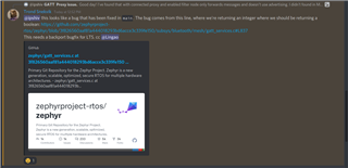

  • Yes, they forwarded, but with this line discards ADV in connected mode.
    In Zephyr's discord this was qualified as bug
  • Hey again Ivan!
    Hmm yeah you are right. Guess I was a bit confused about what you were asking, the info I've given below is still valid though. The error is here.
    Nicely spotted, it will be fixed for NCS 1.8.
