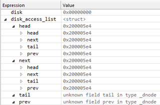

  • Debugging this in Segger I see the problem at disck_access.c in diskaccess_get_di(). The loic with SYS_DLIST_FOR_EACH_NODE(&disk_access_list, node){ } is skipped because disk_access_list has nothing in it.
    It appears disk_access_list is not being populated inside disk_access_register(). I set a breakpoint at the beginning of the function, but it's not being hit.
    Here is the line of code: https://github.com/nrfconnect/sdk-zephyr/blob/main/subsys/disk/disk_access.c#L33
    Here is the value of disk_access_list & disk at the end of disk_access_get_di():
    Side note: "SD" is passed into diskacces_git_di().

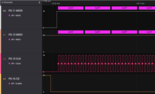

  • With the logic analyser, I can see this weird SPI behaviour on the SD Card...
    CS is down.SCK (14) is beating. MOSI and MISO are down.
    I cannot get why SPI is different on the nrf5340 versus the nrf52 series?

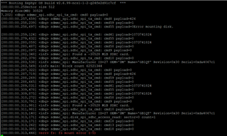

  • Here's my output from the logic analyzer after I found I had the analyzer hooked up wrong. Also, my project.
    .fat_fs_171.zip
