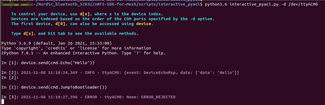

In the serial example, how to use the command JumpToBootloader() to enter dfu mode.
Hi Nordic,
I want to send JumpToBootloader() command to nrf52832 module to make it enter dfu mode and update.
But I got the following error, can you tell me what is the right way.
error : ERROR_REHECTED.
I have successfully updated FW with this command (use button four to enter dfu mode)
nrfutil dfu serial -pkg xxxx.zip -p /dev/ttyACM0
But now I need to use JumpToBootloader() to enter dfu mode.

  • Hi Leo
    Which example are you running on the nRF device when you try to use PyACI to update your application?
    The mesh stack has its own DFU mechanism, which is completely separate from the normal DFU in the SDK.
    The mesh DFU is described here, and is a unique DFU solution designed to handle DFU in a distributed way that slowly sends an update over the mesh network without having to stop the application in the mean time. This is very different from the normal DFU that requires you to suspend the application, but will run much faster.
    The PyACI tool will not work with the standard nRF5 SDK DFU mechanism, and requires the right mesh example to be flashed into the device.
    Best regards
    Torbjørn

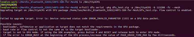

    ### Transferring the DFU archive over serial with nRF Util
    leo@leo-work:~/Nordic_bluetooth_52832/nRF5-SDK-for-Mesh$ ls /dev/ttyACM1
    /dev/ttyACM1
    leo@leo-work:~/Nordic_bluetooth_52832/nRF5-SDK-for-Mesh$ nrfutil dfu serial -pkg dfu_test.zip -p /dev/ttyACM1 -b 115200 -fc --mesh
    Upgrading target on /dev/ttyACM1 with DFU package /home/leo/Nordic_bluetooth_52832/nRF5-SDK-for-Mesh/dfu_test.zip. Flow control is enabled.
    Failed to upgrade target. Error is: Device returned status code ERROR_INVALID_PARAMETER (133) on a DFU data packet.
    Possible causes:
    - bootloader, SoftDevice or application on target does not match the requirements in the DFU package.
    - baud rate or flow control is not the same as in the target bootloader.
    - target is not in DFU mode. If using the SDK examples, press Button 4 and RESET and release both to enter DFU mode.
    - if the error is ERROR_BUSY at the beginning of the DFU process,increase the value of PAGE_ERASE_TIME_MAX by few milliseconds.

    I have successfully used this example to update the APP FW, and I think there are two things wrong.
    The process is the same as I posted above, but in the step 1 "### Step 1: Generate a DFU file with nRF Util" I should change it to the following.
    leo@leo-work:~/Nordic_bluetooth_52832/nRF5-SDK-for-Mesh$ nrfutil dfu genpkg --application bin/blinky/blinky_nrf52832_xxAA_s132_7.2.0.hex --company-id 0x00000059 --application-id 1 --application-version 2 --key-file private_key.txt --sd-req 0x0101 --mesh dfu_test.zip
    One is that "--company-id" must be the same as the "company-id" in the bootloader_config_default.json file, and the other is --sd-req should be 0x0101. (refer to your file s132_nrf52_7.2.0_release-notes.pdf)
    The value of --sd-req on the website is wrong?
