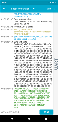

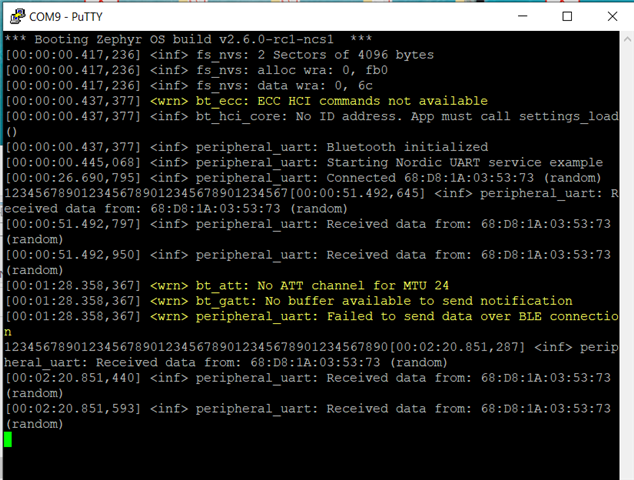

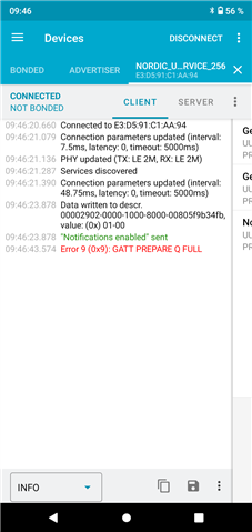

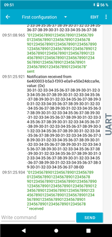

It's work perfectly with nRFToolBox but I realized that it's work diffrently with nRFConnect for Mobile.
With nRFToolBox I can send 239 bytes with Rx Characteristc and Tx charateristic.

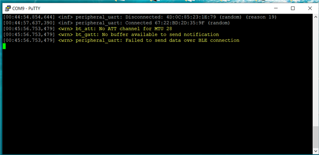

But if i try with nRFConnect I can't send more then 19 bytes with Tx Characteristic and more then 36 bytes with Rx Characteristic.
On Rx I have the "error 9 (0x9) Gatt prepare Q full" when I send 37 bytes and on Tx I have the warning" No Att channel for MTU 24 / no buffer available to send notification / fialed to send data over BLE connection" when I send 20 bytes.
Why is that not working on nRFConnect ?

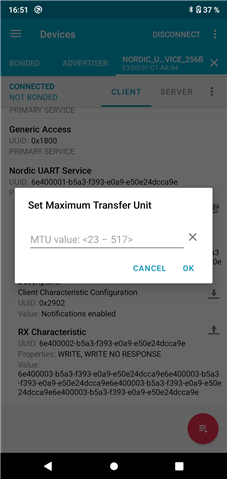

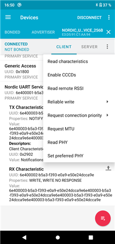

Second question:
During a BLE formation in France I learned that there is a negociation between the central and the peripheral before etablishing a connection about the size of MTU.
I need to transfert a lot of data by the uart connection and I want to be sure that I can send paquet of 239 bytes for each connection with any smartphone (Android).
Do you know how to retrieve the result of the negociation between the central (smartphone) and the peripheral (nrf5340dk) ?

  • It seems like more prepare writes are being performed than the config (CONFIG_BT_ATT_PREPARE_COUNT=2) set. Try to increase this size. It would be really good get a sniffer trance of the whole transaction in the not working setup (mobile) to get an even deeper understanding of the communication between your device and the mobile app.
  • Hi Susheel,
    Thank you for your answer.
    I put "CONFIG_BT_ATT_PREPARE_COUNT=6", now I can send more data on RX charateristic with nRFConnect,
    I will have a look of the limit.
    But on Tx characteristic I can't send more then 19 bytes I still have the same problem.

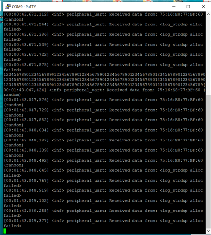

  • Additionnal information:
    With "CONFIG_BT_ATT_PREPARE_COUNT=6" I 'm limited to 108 bytes on Rx characteristic.
    I put "CONFIG_BT_ATT_PREPARE_COUNT=15" then I can send more then 239 bytes on Rx characteristic, but I have a log inf:
    <log_strdup alloc failed>
    What does it mean ?
    Best Regards,
    Rob.
  • Not sure what is happening on the receiver end. A sniffer log would help a lot to understand the issue looking at the communication in detail. The logs are not very informative. Please share your modifications so that i can reproduce this or add detail sniffer logs for this communication.
  • Hi Susheel,
    Thank you for your help.
    I managed to get the sniffer to work.
    There is the communication and the log with nRF ToolBox UART:

    I can see on line 1285 a sent write request where I send a packet 246 bytes (reassambled) and on line 4313 I received handle value notification a packet of 247 bytes (reassambled).
    There is the communication and the log with nRFConnect:
    nrfConnect_peripheral_uart_256a.pcapng
    *** Booting Zephyr OS build v2.6.0-rc1-ncs1  ***

    [00:00:41.223,632] <wrn> bt_att: No ATT channel for MTU 30
    [00:00:41.223,632] <wrn> bt_gatt: No buffer available to send notification
    [00:00:41.223,632] <wrn> peripheral_uart_256a: Failed to send data over BLE connection
    01234567890123456789012345678901234567890123456789012345678901234567890123456789012345678901234567890123456789012345678901234567890123456789012345678901234567890123456789012345678901234567890123456789[00:01:05.717,132] <inf> peripheral_uart_256a: Received data from: 42:4B:13:7B:50:9B (random)
    [00:01:05.717,285] <inf> peripheral_uart_256a: Received data from: 42:4B:13:7B:50:9B (random)
    [00:01:05.717,437] <inf> peripheral_uart_256a: Received data from: 42:4B:13:7B:50:9B (random)
    [00:01:05.717,590] <inf> peripheral_uart_256a: Received data from: 42:4B:13:7B:50:9B (random)
    [00:01:05.717,742] <inf> peripheral_uart_256a: Received data from: 42:4B:13:7B:50:9B (random)
    [00:01:05.717,895] <inf> peripheral_uart_256a: Received data from: 42:4B:13:7B:50:9B (random)
    [00:01:05.718,048] <inf> peripheral_uart_256a: Received data from: 42:4B:13:7B:50:9B (random)
    [00:01:05.718,231] <inf> peripheral_uart_256a: Received data from: 42:4B:13:7B:50:9B (random)
    [00:01:05.718,383] <inf> peripheral_uart_256a: Received data from: <log_strdup alloc failed>
    [00:01:05.718,505] <inf> peripheral_uart_256a: Received data from: <log_strdup alloc failed>
    [00:01:05.718,658] <inf> peripheral_uart_256a: Received data from: <log_strdup alloc failed>
    [00:01:05.718,841] <inf> peripheral_uart_256a: Received data from: <log_strdup alloc failed>
    [00:01:14.638,214] <inf> peripheral_uart_256a: Disconnected: 42:4B:13:7B:50:9B (random) (reason 19)
    I can see on line 9365 I received handle value notification a packet of 18 bytes.
    I cannot see the packet with more then 20 bytes send, where you have the warning "bt_att: No ATT channel for MTU 30 / bt_gatt: No buffer available to send notification / peripheral_uart_256a: Failed to send data over BLE connection" on the log message.
    I can see on line 10799 a sent write request where I send a packet of 18 bytes,
    line 10805 18 bytes more, line 10811 18bytes more, line 10817 18 bytes more..
    For a total 12 packet of 18 bytes where send (216 bytes).
    There is my project:
