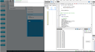

To verify my code I am working with nRF Connect 3.7.0 and Bluetooth Low Energy tool.
On nrfDongle (Client) connection interval is set to 30ms.
I am testing some cases and my observations are:
1. When I try to send notification (call sd_ble_gatts_hvx) slower than connestion inverval (e.g. 35ms) app works.
2. When I try to send notification (call sd_ble_gatts_hvx) little bit faster than connection interval (e.g. 25ms) it still works. I observe how number of free Tx buffers is changing between 27-30. Observing this changes is possible by adding counter wich is decremented after sd_ble_gatts_hvx() and incremented when event BLE_GATTS_EVT_HVN_TX_COMPLETE occurs. So in this case app it works as expected.
3. When I try to send notification (call sd_ble_gatts_hvx) faster than connection interval (e.g. 20ms) after few seconds of operation there is no free TX buffers and sd_ble_gatts_hvx returns NRF_ERROR_RESOURCES.
It looks like Soft Device is too slow. I have made some time measurements and time between calling sd_ble_gatts_hvx() and the occurrence of BLE_GATTS_EVT_HVN_TX_COMPLETE is between few to more than 20ms.
I suppose there is problem with my settings.
What should I do send multiple packets at every connection interval?
Do you see any issues with my code?
