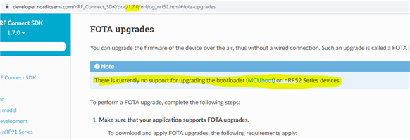

I am using ncs 1.7.1 to add an upgradeable boot loader, but I can’t find a way to upgrade the bootloader. Can I upgrade the bootloader on 52832?
In NCS v1.7.x, there is currently no support for upgrading the bootloader (MCUboot) on nRF52 Series devices.

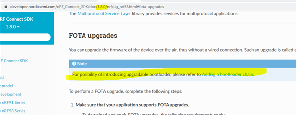

Regarding the NCS master branch, check out Adding a bootloader chain to see how to use an upgradable bootloader.
Simon

It was not supported in NCS v1.7.0
But in NCS v1.8.0 it should be:
